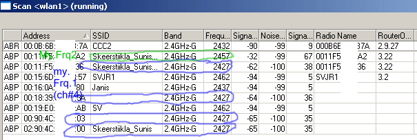

Signal is good, even very good to drop connections. Mostly main router AP assumes, that needs to disconnect a wds-slave (drops every <1h).
I do atach 2gifs:
What’s the matter??
