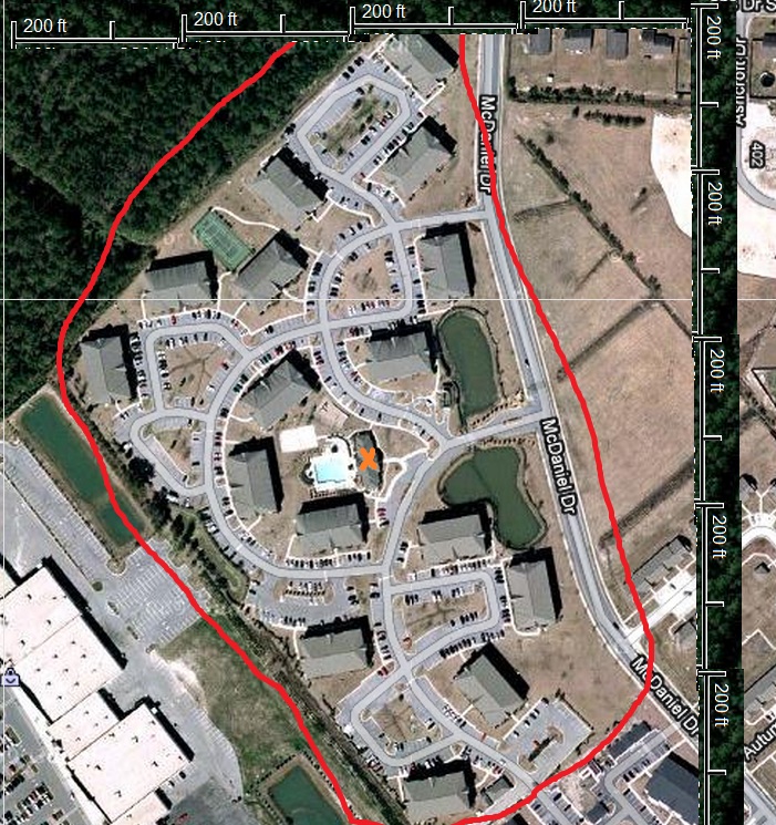

I originally planned on mapping the effective range of an omnidirectional antenna on the groove, and determining the best layout for the map (attached below). But now if I use the groove + additional re-broadcasting routers that would also be a bit different. Ideally this would cover all outdoor areas, as well as have enough power to be used in the apartments.

My goal is to have wireless available on the map below, with the internet source being located where the orange X is near the center of the map. Wireless should be available in the buildings, and a plus would be having it available outside as well.
I wanted to set up the groove to be a AP-bridge, that could extend the signal farther out, in multiple nodes, with an omni-antenna, as well as serving the connection to anyone in proximity of the groove.
I realized to do this I would need wireless adapters on each computer laptop that could read 5ghz, or else additional access points that would interconnect with the groove at 5ghz, and serve up 2.4ghz as access point.

You could run a simple, single radio HMWP mesh setup and just plug your APs into the groove. We have plenty of such setups and for general wifi internet access it works very well, despite the bandwidth tradeoff associated with single radio.
His requirements are a bit more complex as the end goal is to provide a high speed connection to every apartment. It’s the equivalent of building a 350+ customer WISP in a small footprint with the resulting issues. The 2.4ghz noise levels are going to be high since most people will have wireless routers.
Ah, i assumed as he was using Groove’s with Omni’s he was looking for a more basic solution.
