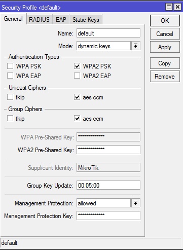

What I cannot understand: why there is wpa-psk appear in the authentication-types, because in the WinBox I see that it isn’t enable (attached). I have no iPhone5, most trouble devices are my iPad2. My MacBookPro have Broadcom chipset.
Also enable regular WPA not just WPA2, see if it helps

Very frustrating bug.
I agree, but in all fairness I can’t see the problem with RouterOS since the issue is present on all major router / AP systems. PRO and consumer. Apple should get the boot for it!
Yes, I was more looking for a clever work around whilst we wait for Apple to do something.
Ie using a different authentication method or disabling auth completely and using mac based access control or something.
