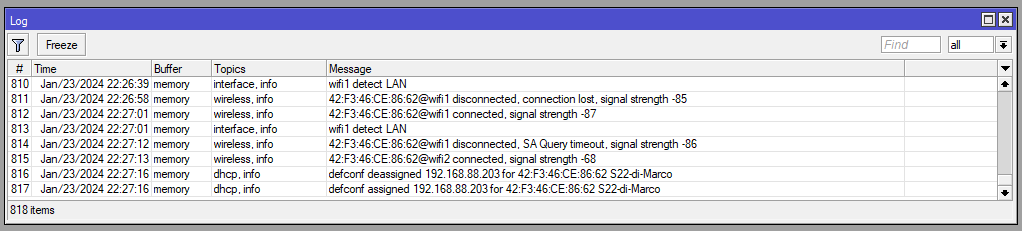

Hi, in the image log of the connection attempts to the Wifi1 network (@5.5GHz, 80MHz bw)). I don’t understand why this happens, any suggestions? Many thanks
See : http://forum.mikrotik.com/t/v7-11beta-testing-is-released/167585/88 about SA Query timeout.
The rest is about using WPA2/WPA3 combination, setting FT enabled or not, and cypher settings.

the log I sent was generated with the phone stable on a desk, in positions where it was previously able to steadily connect to the 5GHz network.
If both 2.4GHz and 5GHz networks are active, it seems that the devices don’t “decide” to use the 2.4GHz network if the signal from the 5GHz network is too weak. If I disable the 5GHz network, all devices connect quickly and without hesitation to the 2.4GHz network.
