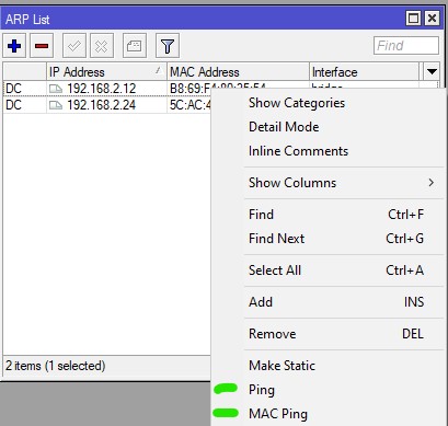

Is this ARP ping or MAC ping ???
There is IP PING and MAC PING (not all interfaces are set to respond to MAC requests by default).
Both have the option of ARP Ping, and then do require the interface to be specified.

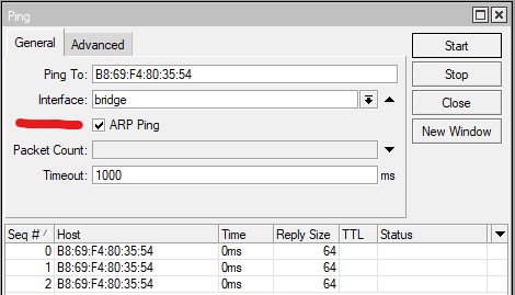

On images you ping the RouterBOARD, is not the same with Amazon devices:
How to ping Echo Plus:

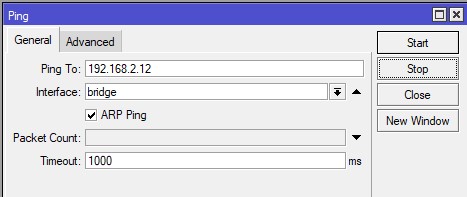

I should have been more specific - and titled this thread a bit different… Your last screen capture (klembord-2.jpg) was exactly what I was doing when trying from the WinBox ping command. I have tried it both with and without the “ARP Ping” checkbox set. Same result - timeout on every device I have tried on every interface except my other router.

Klembord-2.jpg is a regular ICMP PING, or is a normal ARP request (if ARP Ping is ticked) based on IP address.
For the regular ICMP PING specifying the interface is not needed, normal routing is used.
For the ARP Ping option, the interface is needed, as this is not normal IP traffic, but a supporting L2 protocol. (ARP and RARP)

The IP address based PING and ARP Ping … I don’t see the difference with Amazon Echo. MAC Ping was only there because OP wanted ARP Ping but used the MAC Ping syntax.

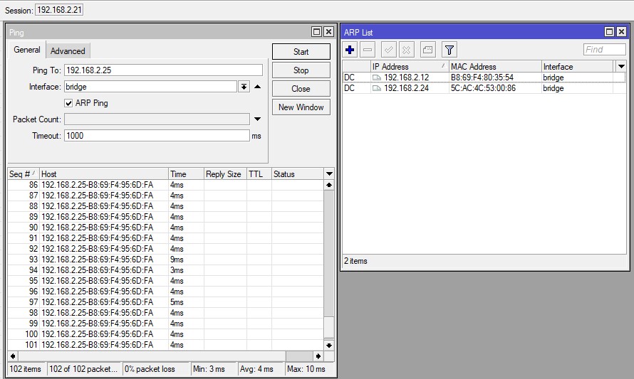

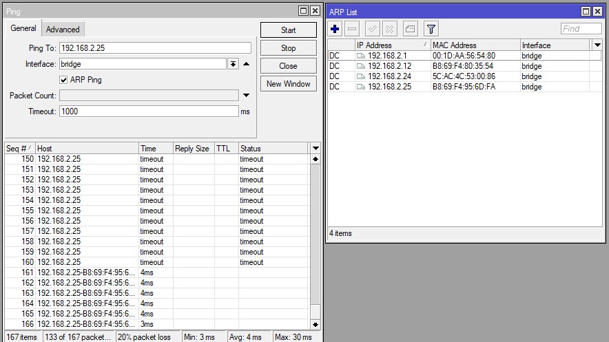

ARP Ping from 192.168.2.21 (MT) to 192.168.2.25 (MT connected via wifi-ether-switch-ether) … I see some things
  1. The 192.168.2.25 is NOT in the ARP list (it only appears when I do a regular ping, it is not triggered by an ARP Ping)

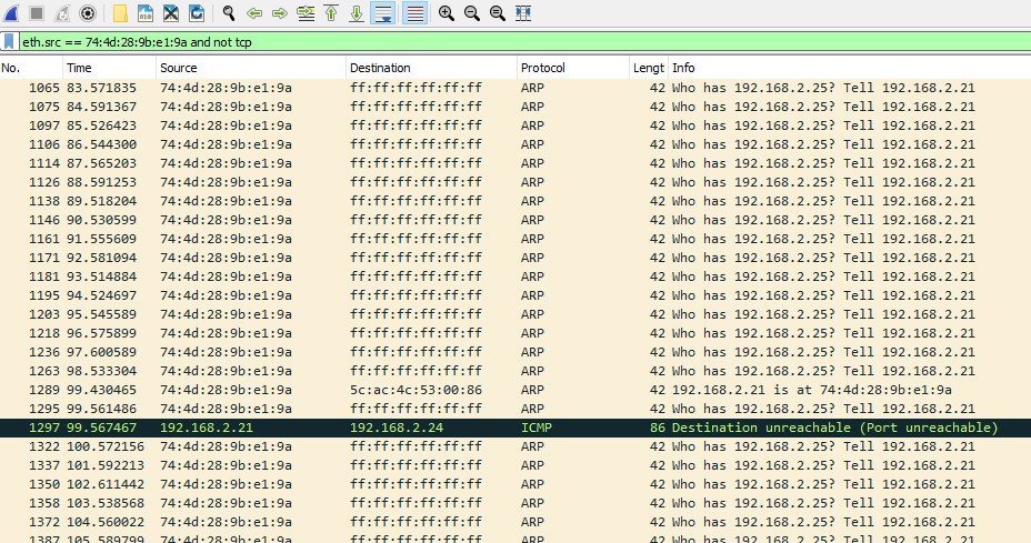

  2. My laptop on the same L2 networks, sees the ARP requests from 192.168.2.21 asking for the MAC of 192.168.2.25 , when the ARP PING is running
  3. Sometimes there is a regular ping to 192.168.2.24 (my laptop). The ARP answer is also send to the 192.168.2.24 from the 192.168.2.21 (my laptop is connected with winbox)
  4. If I check a device that is connected to ethernet interface or WLAN interface of 21, the time is zero or near zero. (23 is wifi connected). The MAC addresses are not in the ARP list.
    And to conclude. If The 192.168.2.25 is active in the ARP table , but removed (in this case rebooted), then the ARP ping goes in timeout instantly, while the entry is still in the ARP List
    So the ARP list is not used by ARP PING , is my deduction.
