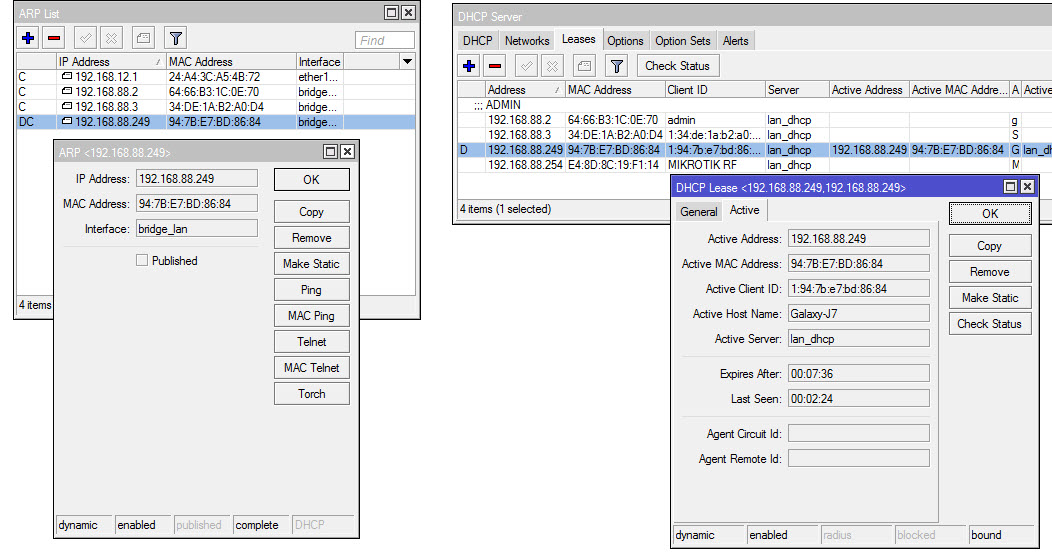

  1. This one is pretty easy. The ARP table is used for the lookup of MAC-Addresses (OSI Layer 2) based on IP-adresses (OSI-Layer 3). This is needed for the transport from the IP-packets towards an client. For more info on ARP you can look in the wiki (https://wiki.mikrotik.com/wiki/Manual:IP/ARP). If you use the option make static under IP > ARP you’ll make the ARP entry static, this may result into trouble. Because a host can have a different IP-address than in the ARP table.
For your purpose: go to IP > DHCP Server > Leases and select the client you want to give a fixed DHCP address based on MAC-address, and select Make Static there. This will reserve the IP-address for that client and MAC-address only. After selecting Make Static you may close the window and re-open the selected client to change the IP-address that will be assigned.

  1. The left half of screenshot shows normal operation of an ethernet switch (RB bridge is very similar). In order to effectively forward ethernet packets, switch has to learn MAC addresses of connected devices on physical/VLAN port. It does so automatically by noting sender’s MAC address and using this information for passing return packets.
    The right part is DHCP server in operation. DHCP server identifies client by their MAC address, but that’s about the common part between left and right part. After DHCP server dynamically assigns IP address to a client, you can make that assignment static by clicking “Make Static” button.
