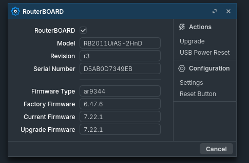

There's a mismatch in 7.22.1 software and firmware 6.49.19. Get firmware same as software. System - Routerboard - Upgrade - Reboot when instructed.

I had already done that before writing my initial message. Take a look at the screenshot.
