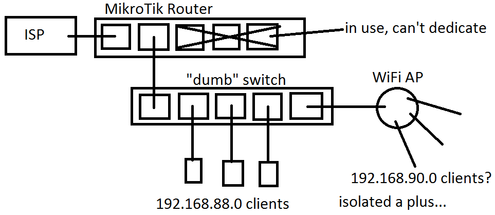

Assign unique DHCP server to an AP?
I’ve got a hEX S (mmips) running v6.46.6, and am using Winbox. I’m pretty good about doing the legwork to figure things out but this is so out of my territory that I don’t know the vocabulary to even do searching… just knowing whether it is possible or not would be helpful!
Maybe just which areas I’ll need? Am I gonna need to create a virtual interface or something? Ive been able to assign different DHCP servers to different physical ports on the router, that wasn’t too bad. Here’s what I’m trying to do. Thank you in advance anyone that takes a look, much appreciated!
Edit: the access point is TP Link, not a MikroTik product…my searching tells me that this probably matters.

Since the AP is supposedly a smart device it would be able to take in both vlans and then distribute them to users as per assigned SSID etc…
IF your AP is not smart, cannot read vlan tags, then you cannot do two different vlans or outputs on the switch as far as I know. and you can ignore everything below LOL
Which model of tp link is it??
There was another thread recently that was similar.
You didnt provide enough detail for ports 3,4,5 and whether or not the AP has more than just .90 ??
So my assumption is that .88 is your home LAN and thus is the same as ports 3,4,5
.90 is guest wifi

Lets make it more complicated LOL
Lets say 88 was not your home network (but for specific other purpose) but .55 was a home network using ether3,45, and also you wanted the TP link carry vlan 55 as home wifi, as well as the guest wifi (only possible assuming TP link is smart)
