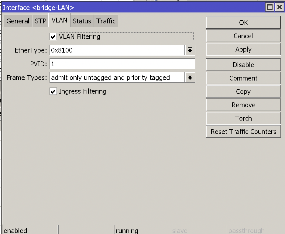

erlinden, I’ve completely missed that. I’ve tried and enabling VLAN filtering completely breaks the guest and IOT networks. They can’t reach internet and when I leave them I’m unable to join them again. So there is really something wrong with my VLAN setup.

I’m still unable to figure out why the VLAN filtering breaks everything (= my devices are unable to join the SSIDs anymore).

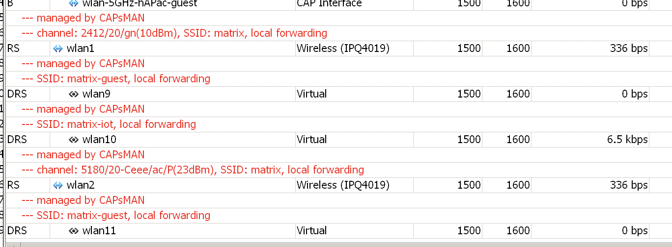

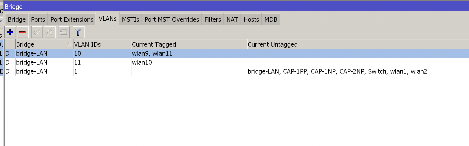

Is this dynamic VLAN confing on bridge all I need? I’m not sure what else should I define, since the wlanXX interfaces are created by CAPSMAN.
