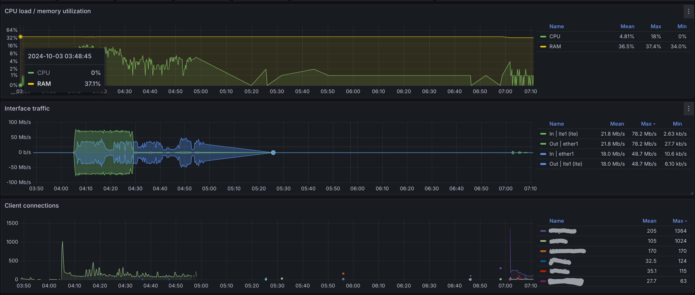

Been using an ATL LTE 18 while I wait for a fiber connection, and it works great aside from a non-trivial issue: in the past few days, every couple of days it slows down to a crawl.
Symptoms are like a system being bogged down by CPU/disk usage: very unresponsive on all fronts, but I’m still able to log in (with a lot of patience) and issue a reboot command. Rebooting fixes everything for another couple of days.
Problem is, I’m not seeing a CPU spike when this happens. I set up mktxp to track counters, and I am attaching the view from this morning when the slowdown happened again. Around 7AM I restarted the router, and now all is fine.

The part of the story missing is the LTE metrics. If you’re doing monitoring, adding RSRP, RSRQ, and SINR likely be useful since it could be on the LTE carrier side (i.e. time-of-day, changing bands, etc.) which some data either confirm or rule-out.
Now the dramatic drop in traffic might indicate some device-side issue… But the first thing to check is the ATL is fully updated including RouterOS, RouterBOOT (in /system/routerboard), and the LTE firmware (/interface/lte). Often the factory installed version is pretty old and Mikrotik does routinely update LTE support. If these versions get mismatched, that where you often seeing more random problem IMO.

I did add LTE metrics at the time right after posting, and LTE is rock stable. And yes, everything was up to date: os, modem and routerboard firmware.
