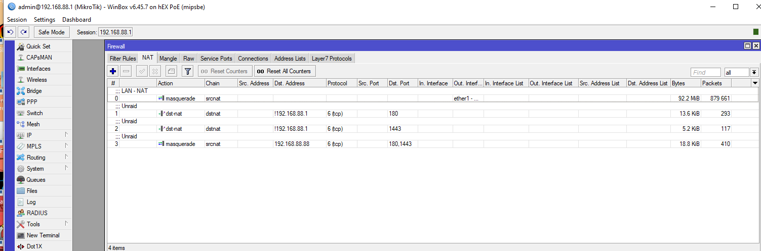

-I have a Mikrotik hEX PoE Routerboard with port settings visible in image 2, or as follows:
add action=dst-nat chain=dstnat comment=Letsencrypt dst-port=80 dst-address=!192.168.88.1 protocol=tcp dst-address-type=local to-addresses=192.168.88.88 to-ports=180
add action=dst-nat chain=dstnat comment=Letsencrypt dst-port=443 dst-address=!192.168.88.1 protocol=tcp dst-address-type=local to-addresses=192.168.88.88 to-ports=1443
add action=masquerade chain=srcnat comment=Letsencrypt dst-port=180,1443 dst-address=192.168.88.88 protocol=tcp
Where 192.168.88.1 points to the Mikrotik router and 192.168.88.88 points to Unraid.

According to picture1 Technicolor already performs port change for HTTP and HTTPS and mikrotik gets hit with requests to port 180 and 1433 while current DST-NAT config on mikrotik expects them to arrive at standard ports…
Changed settings as shown in the image, letsencrypt still comes up with:

The screenshot you posted shows only part of NAT setting details. Post output of /ip firewall filter export.
Counters show that some connections did hit those rules, which means RB is getting connection attempts.
