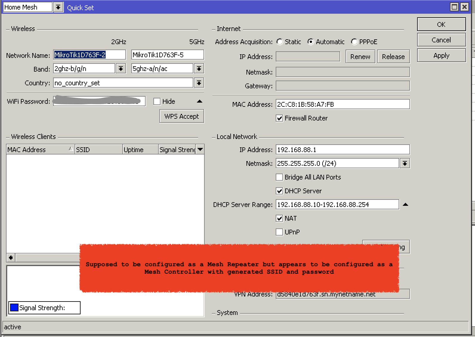

I deployed my mesh during the weekend, ensured every unit was on the latest version of routerOS (6.49.6) and it was a failure: even if the controller and repeater Audience unit where showing the green light indicating that the pairing was successful, the mesh network was completely broken:
  • Only the controller unit activated the user facing 2.4G and 5G wifi channels in addition to the backhaul channel when the repeater units were only activating the backhaul wifi channel
  • The repeater channels didn’t appear in the Caps Man / Remote CAP list
  • I no longer succeed in resetting the Audience units to factory settings, all my “mesh repeater units” are now stuck in a config where they are started as a “mesh controller” with generated SSIDs and wifi password. I can verify this unexpected configuration using an ethernet cable on ETH2 of the “mesh repeater” units.

I tried both of these reset procedure and when going through Winbox, I tried bit with the option “Keep default configuration” checked and unchecked.
I tried those procedures both with RouterOS 6.49.6 and 7.5.0.
Unfortunately, none of these solutions worked so I opened a support ticket with Mikrotik.
If you managed to connect the repeater devices to the main one, it means that the wps button still works?
I connected to the repeaters using an Ethernet cable on ETH2 and was assigned an IP address, I can connect both with Winbox and the web admin console.
I’m waiting for the guidance of Mikrotik support, looking for a solution to properly reset my units to factory settings and then try a clean slate setup with RouterOS 7.5.0 or trying any procedure I would be recommended to follow.
I found a solution to reset my Audience units and get the “WPS Sync” button to trigger a pairing with the controller unit.
The reset button didn’t work for me (RouterOS 6.49.6 and 7.5.0) so I connected with Winbox on ETH2, launched a reset from Winbox and pressed on the WPS Sync button during the restart.
