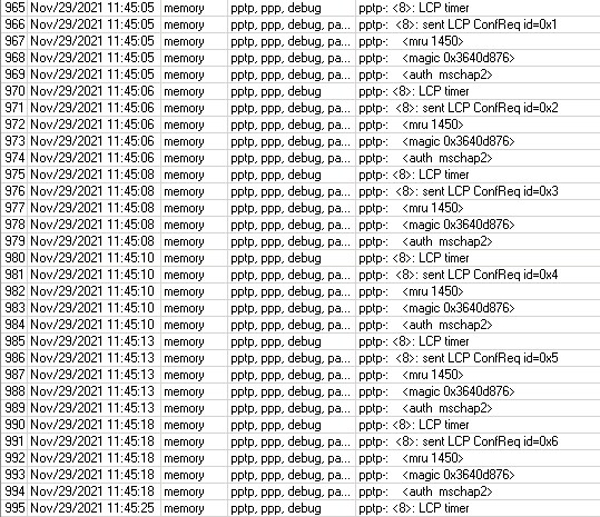

i have windows PDC with Radius and Mikrotik with “use radius” checked and radius server set:
but pptp log shows that authentication goes as simple mschap2 no radius at all:
zhura@10.10.201.1 (RVR-MT-MAIN) - WinBox (64bit) v6.49.1 on CHR (x86_64)_2021-11-29_13_28_37.jpg
need help - what can be wrong?
problem was in firewall rule “block invalid packets” - it blocks GRE. i set rule to “block invalid TCP packets” and now all works fine
