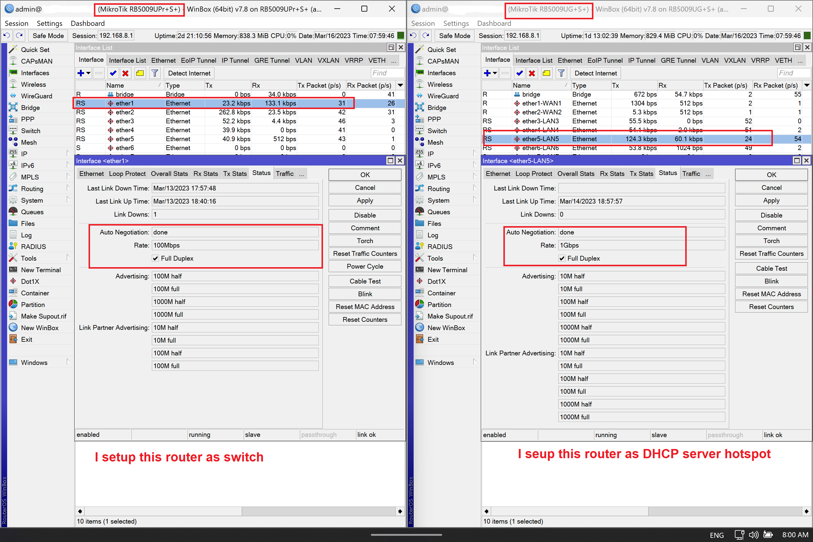

Dear all
I have 2 Mikrotik Router (MikroTik RB5009UG+S+ and MikroTik RB5009UPr+S+) the first one I set it up as hotspot DHCP server located in grand floor and the secund one I set it up as a switch located in first floor and I connect them with cat6 cable but the speed on MikroTik RB5009UPr+S+ (100M) only I supposed to get 1GB because auto negotiation is enable on both devices and if I make any change on advertise I can’t connect to internet and even on devices as well

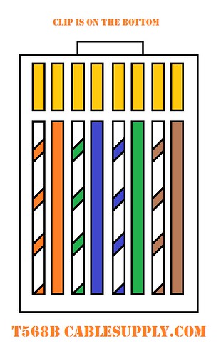

  • cable is terminated non-properly. Either on patch panel or in connectors. Cable has to be terminated in the same way on both ends. There is a standard of doing it with two variants (TIA/EIA 568 A and B) and it’s critical to follow the same variant on both ends of cable.

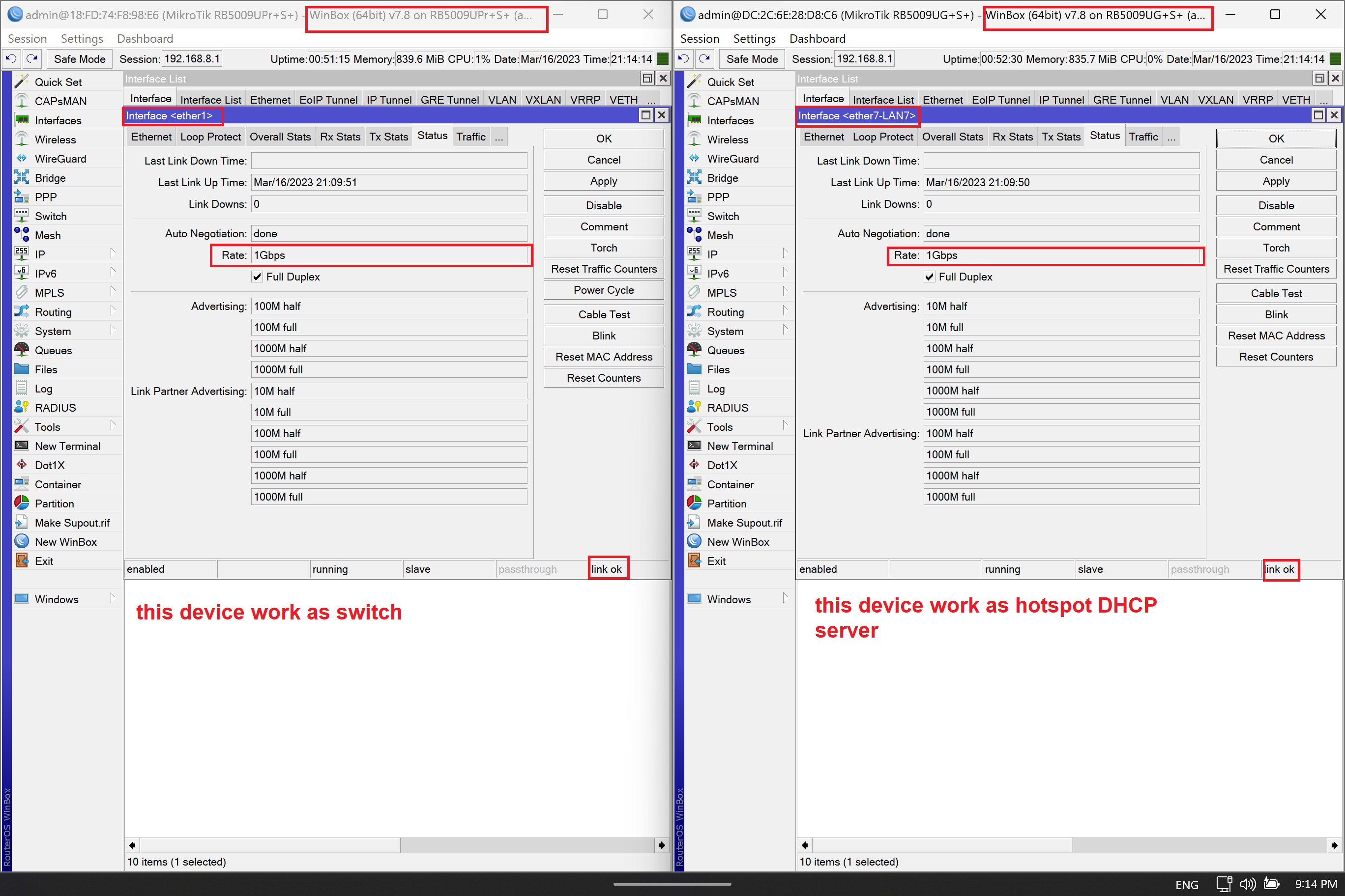

after I read your reply I found one end of ethernet cable on A mode and the other end on patch panel on B mode and I change it to all B mode and the port speed reach to 1g and I can tell you that after solving this issue I reach up to 965Mbps
thanks agene
