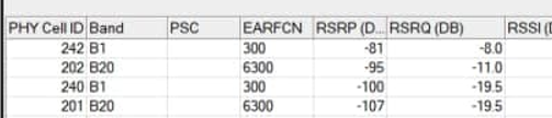

B1 cell-ID 242 and 240 received by another modem (R11e-LTE6 Mikrotik), same BTS, SIM and operator:
so B1 EARFCN 300 (PHY Cell ID 242) exist ad it is operational for that BTS.
