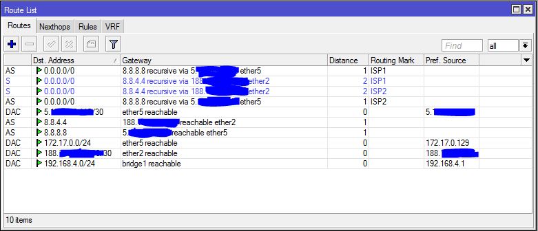

add dst-address=Host1 gateway=GW1 scope=10
add dst-address=Host2 gateway=GW2 scope=10
add distance=1 gateway=Host1 routing-mark=ISP1 check-gateway=ping
add distance=2 gateway=Host2 routing-mark=ISP1 check-gateway=ping
add distance=1 gateway=Host2 routing-mark=ISP2 check-gateway=ping
add distance=2 gateway=Host1 routing-mark=ISP2 check-gateway=ping
is this currect? or need somthing more?
its not work !
need more details. how do you mark necessary traffic, what do you expect and what goes wrong?
i want if main gateway’s internet go off switch to second gateway
and what happens instead?
