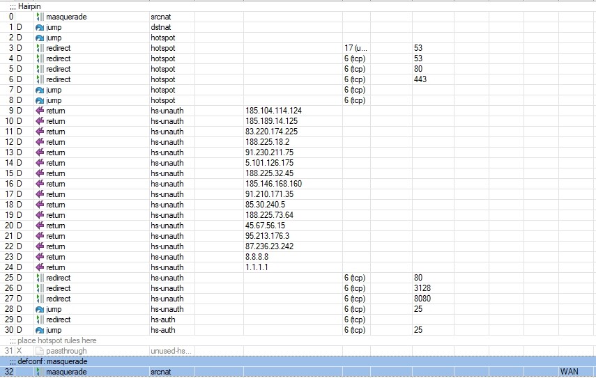

Thanks, actually I’m using CAPs to allow access guests by a second SSID which stay into the public bridge, the router serves DHCP on that network but the gateway is connected to several scripts for autentication.. so I can’t simply filter by src interface. I may filter the gusts subnet..
Please tell me if I?m not right, chain=postrouting is for Mangle and I don’t see it on filter rules, as for drop I can’t find it under mangle. SHould I mangle and mark packets, then drop them on filter rules?
That looks like the Mikrotik Hotspot rules. So assuming non-guests using a normal SSID, you might be able to use the hotspot= match in a filter rule. I can not test it but something like:
/ip/firewall/filter/add hotspot=auth chain=output out-interface=lte1 action=drop
/ip/firewall/filter/add hotspot=from-client chain=output out-interface=lte1 action=drop
Unfortunately I cn’t find a way to use hotspot in the filter rule, anywhere else too..
ANyway, I’ve created a postrouting mangle with src address the subnet for guests and out interface LTE1, and I marked packets. Then I’ve created a filter rule foward with that mark and drop action, I thin it should work somehow
