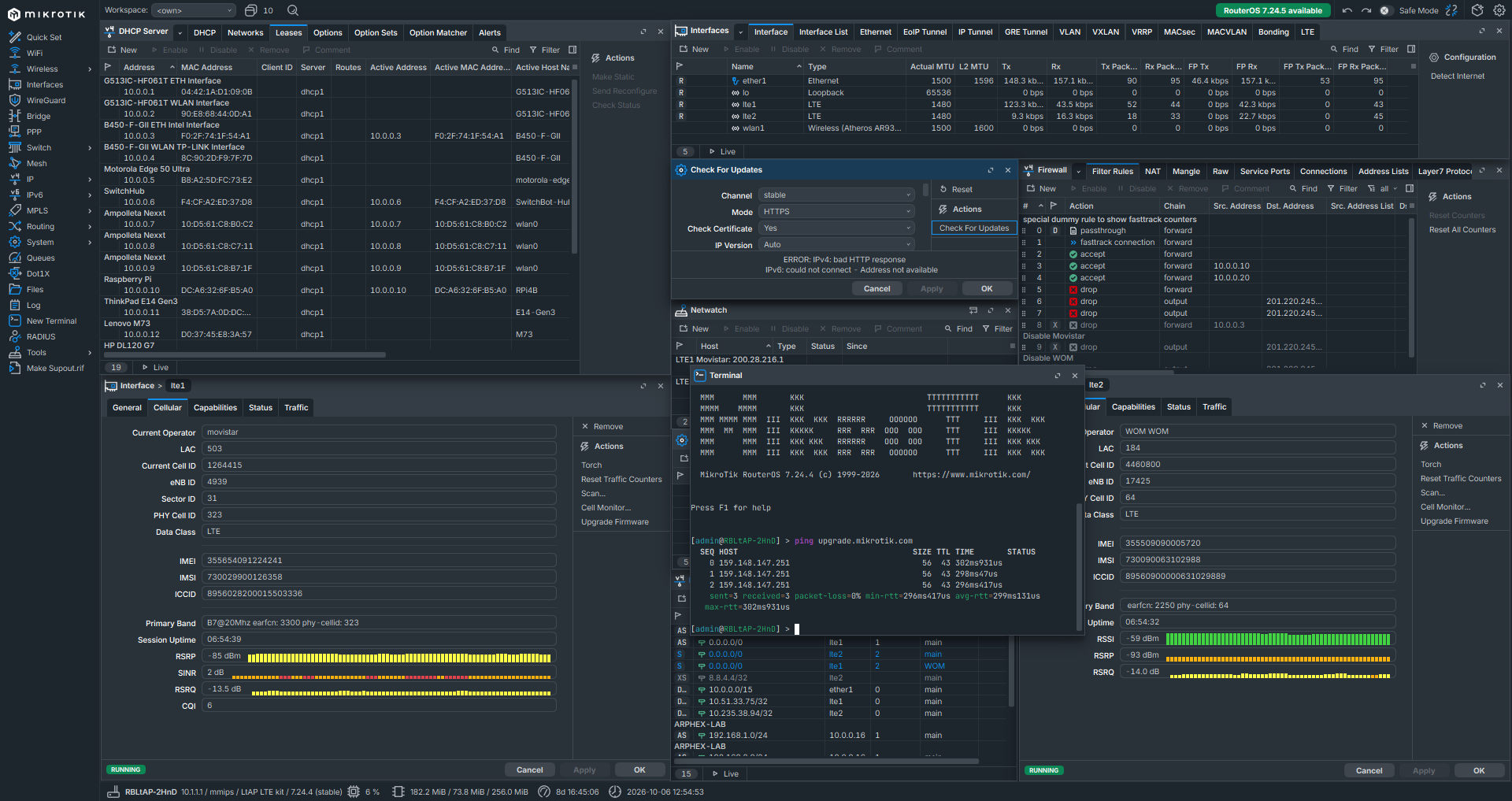

I have the same issue. Not using PPPoE. I use LTE.
I can ping to upgrade.mikrotik.com successfully but anyways I got Bad HTTP Response.
