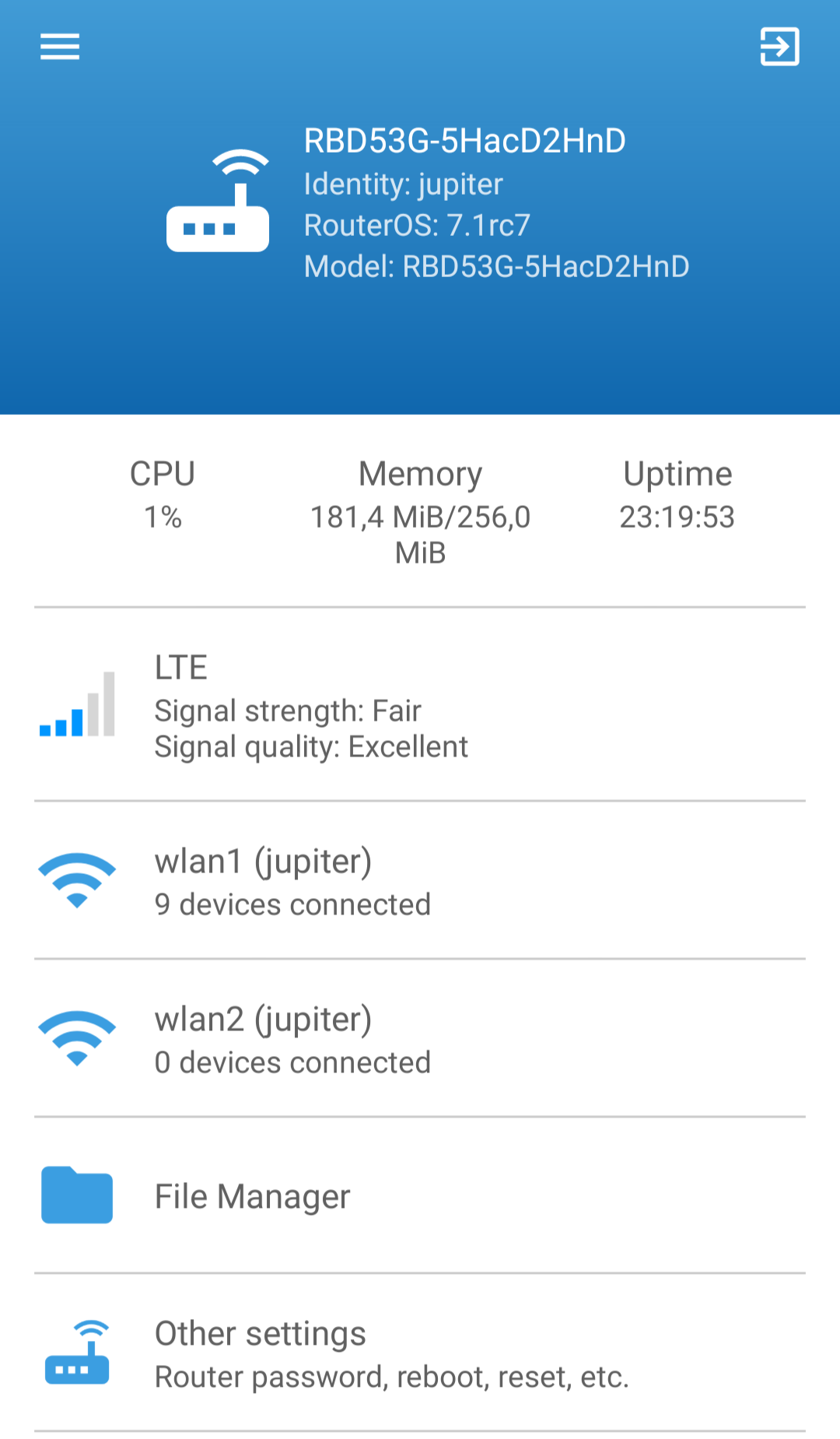

This is how it looks like without access list rules. It is quite useless to have 5ghz enabled at all, as not a single client would connect to it. they all prefer wlan1 cause of slightly better RSSI.
t
