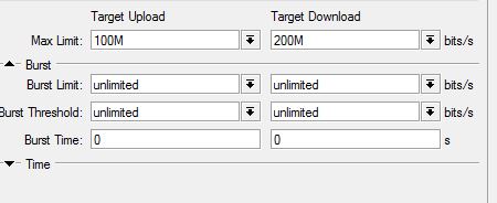

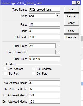

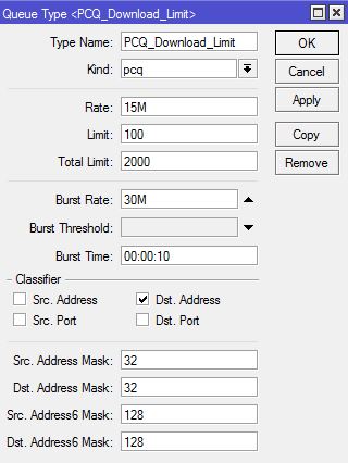

Mine look like this and seems to be working as expected, utilizing Simple Queues, using the queue types for the configuration.
