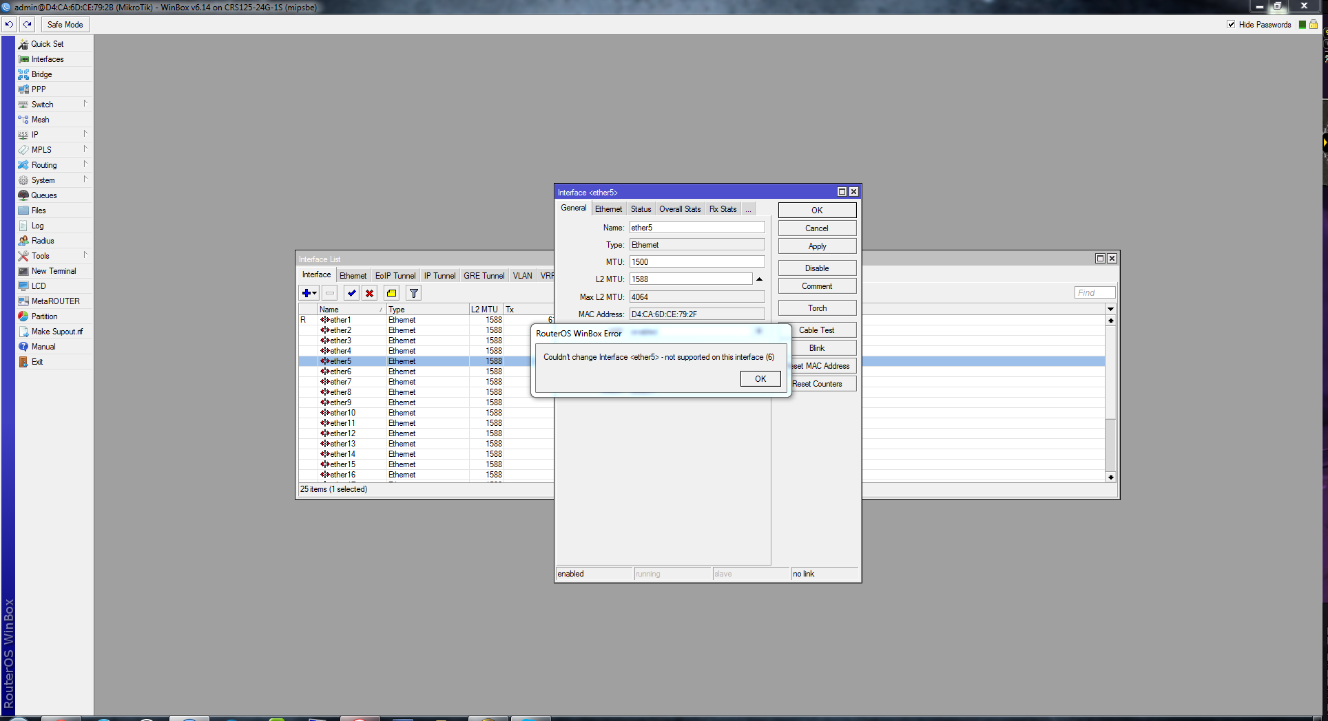

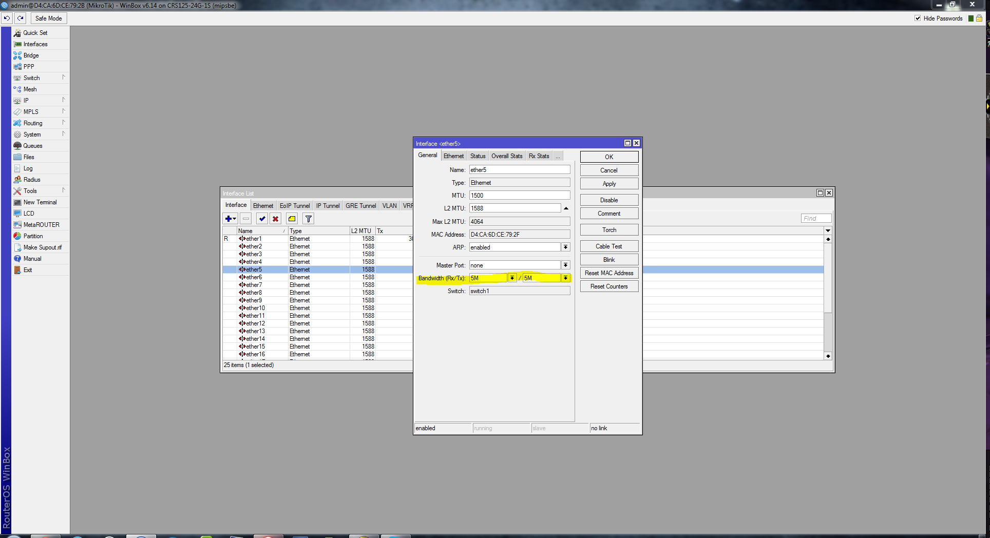

I am using a CRS125 on 6.14 and I am wanting to limit bandwidth usage based on port not IP address. I have tried going into the interface settings and setting the limit there but I get the following error; “Couldn’t change interface not supported on this interface (6)” doesnt matter if I have the interface in a bridge or not.
