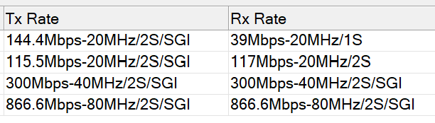

I’ve observed its reported differently between these two devices.
On the hAP AC, 40MHz operation at the highest rate shows up as 144.4Mbps-20MHz/2S/SGI
On the hAP AC2, 40MHz operation at the highest rate shows up as 300Mbps-40MHz/2S/SGI
There is certainly no 80MHz operation on 2.4GHz which is what the AC2 implies if the AC’s readings are to be taken similarly.
I know they use different wireless chipsets (Atheros AR9300 vs Qualcomm IPQ4019) but it’s still confusing.
In summary, my question is this:
Is there a major hardware or throughput difference I’m failing to acknowledge or are these just same same but different? :smiley:
Take https://mcsindex.com/ as reference document: HT = 802.11n , VHT= 802.11ac, (HE =802.11 ax)
The above interface rate is:
  • HT MCS15 (or 2x VHT MCS07) encoding, rate is 144.4Mbps
  • bandwidth is 20 MHz (not 40MHz)
  • 2S= dual stream (two independent data streams, uses 2 antenna)
  • SGI = short guard interval 0.4µs
  • HT MCS15 encoding, rate is 300Mbps
  • bandwidth is 40 MHz
  • 2S dual stream
  • SGI short guard
243Mbps-40MHz/2S
is HT MCS14 (or 2x VHT MCS06) , interface rate 243Mbps, bandwidth 40MHz, dual stream, long guard
Some rules:
  • bandwidth 20/40/80 is negotiated, but mostly set by AP (client must be able to execute, and normally keeps all options open, but may not have 80MHz)
  • MCS index is dynamically changed, independent for both directions. Bad transmissions (>HW retry) makes the interface step down in MCS , good transmissions trigger step ups
    -dual stream: if both devices support it, and if the radio can maintain it. Sometimes 2S is dropped as not maintainable. Client and AP # of antenna defines max # streams.
    So: hAP AC is 3S, but except for iMAC not many clients have 3S. e.g.: Tablet will connect as 2S
    So: laptop is mostly 2S, tablet 2S, smartphone 1S. Smartphone will always connect as 1S to hAP ac and hAP ac2, (even to the 4x4 Audience).
  • short guard: as set in AP. short/long/auto. With auto it depends on signal quality
In 802.11ac in 40MHZ/2S/SGI highest MCS09, interface rate is 400Mbps
In 802.11ac in 80MHz/2S/SGI highest MCS09 , interface rate is 866,7Mbps
In 802.11ac in 80MHz/3S/SGI highest MCS09 , interface rate is 1300Mbps
Effective user datarate is much lower. The overhead becomes more important with higher interface rates. A lot depends on the driver and the aggregation used. http://forum.mikrotik.com/t/ac2-vs-ac3-wifi-not-over-200mb/148289/1
On MT 400Mbps interface rate yields 260Mbps, 866Mbps drops to 360Mbps. (other brands and wifiwave2 drivers will go to 500Mbps+)
Both devices running ROS 7.1.1

This is getting stranger for me then. My hAP AC is not negotiating 40MHz despite all clients supporting that mode of operation.
I just tested with an AX1650 and it definitely negotiated 40MHz with it but the others stick to 20MHz operation like 40MHz is the plague.
It doesn’t make sense but okay. See below, the AX1650 is the 3rd on the list and the last for the 2.4GHz interface.

I’ll keep looking I guess, but the same behaviour continues. AX1650 registers as 40MHz, everything else maintains 20MHz.
In all likelihood, it might be the hardware but it seems highly unlikely since I know from specs that other devices support 40MHz operation.
Even if it’s 1x1, they support it. Eh, wireless clients are weird.
