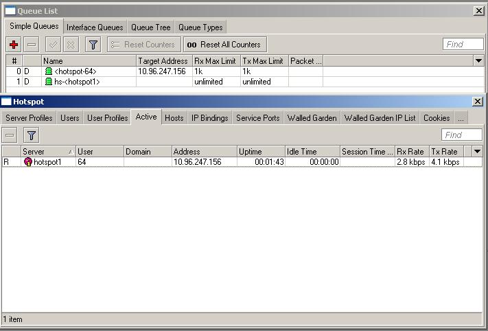

I am using ver 3.22. Set a hotspot and using radius to authenticate clients. I restrict bandwidth in UserManager. when Clients login, some how bandwidth restriction is not working and he gets whole bandwidth. When I goto to queue screen in winbox, a queue is created but queue does not shows any activity is term of TX/RX.

I have not had that problem, but the first thing I would check is the “Target Address” for user “64” on the simple queue list and the ip address for user “64” in “/ip hotspot active”. Are they the same ip?

they are same. Please check the below screen shot.
