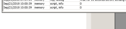

Hi Adahi! Thanks for your reply.
I have tested your script, and apparently the bandwith test is running correctly (I see the traffic in the interface) but in the log, the displayed values are “0” and “0”. Do you know what can be wrong?
Thanks in advance!

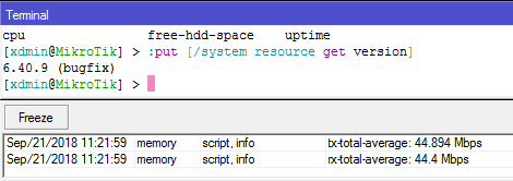

it was working on bugfix versions
modify script required for stable versions
Dear Adahe,
Thanks, it seems that it did not work the first time but the next ones is working properly! :slight_smile:

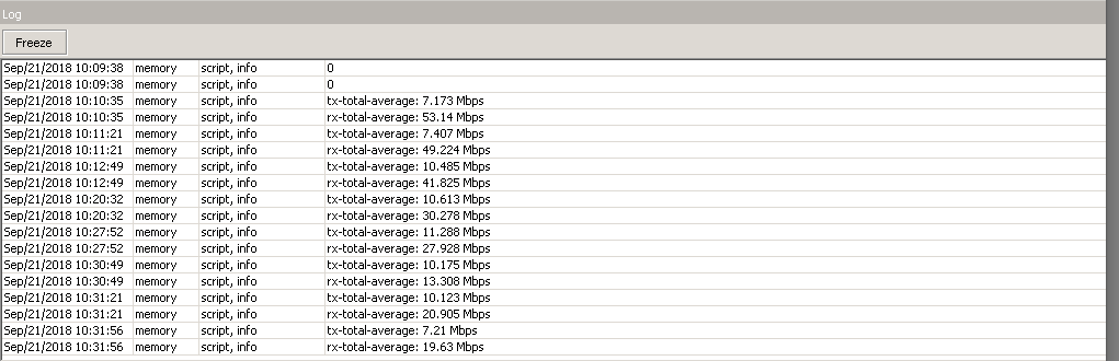

I have modified the script from Adahi so it stores the results in a text file, so the script can be scheduled daily to analyze the BW-test result on different days. I have added comments too. I share with the community, just in case! :slight_smile:
