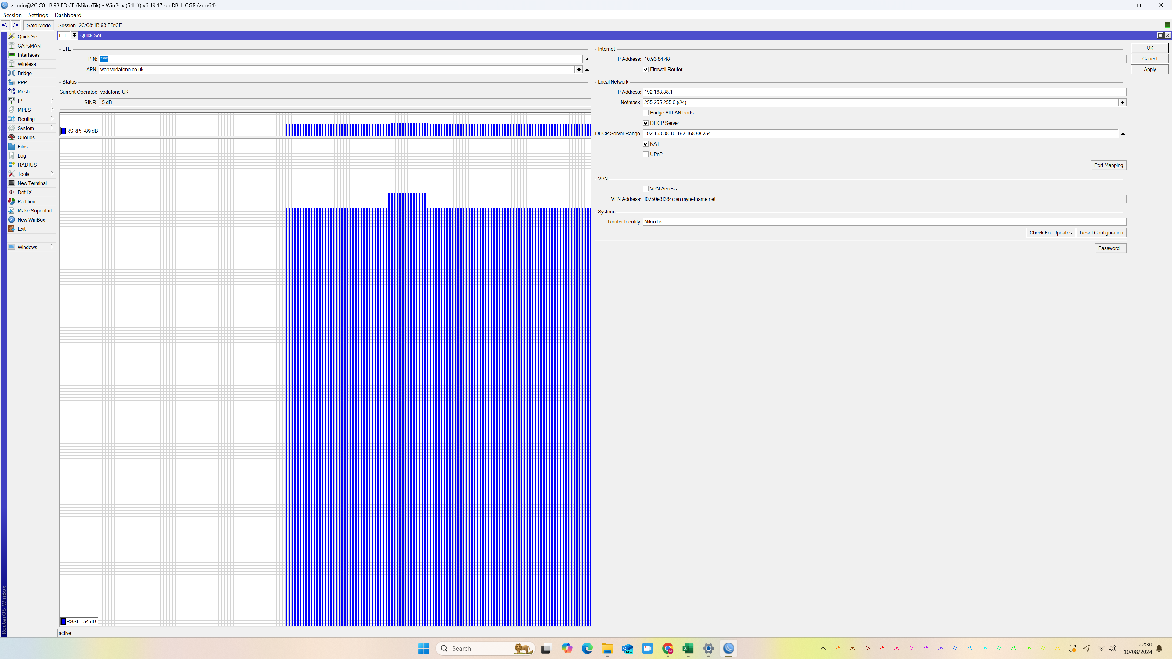

I am getting a signal but cannot get connected to the internet - I have attached a screenshot of my Quick Set settings and a picture of the LED’s on the aerial/router
Please can someone have a quick look and tell me if any of my settings are batantly wrong or if I need to check a box that is unchecked( I am not technical and have got this far using Google and Youtube! )

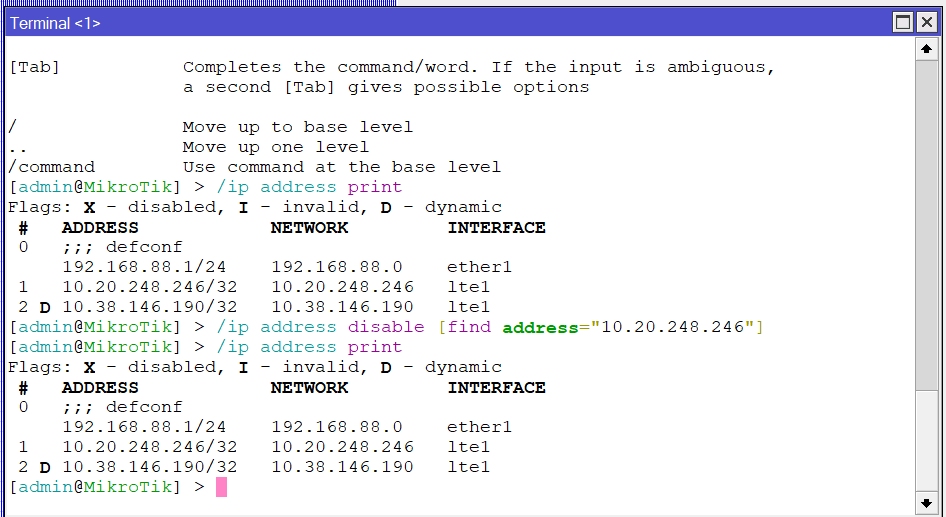

I am sure it can be done also in the GUI, but it is easier/faster if you open a terminal window and try running in it:
/ip address print
/ip address disable [find address=“10.20.248.246”]
Explanation:
When you run the first print command it will show the current IP addresses assigned, with a number besides them, very likely the 192.168.88.1/24 is #0 and the 10.20.248.246 is #1, but I cannot be sure from here, if this is the case the command:
/ip address disable 1
is simpler and will work the same, but the previous one should work and risk not disabling the “wrong” address.
Then run again:
/ip address print
that IP address should be marked as disabled.

Hi jaclaz
I have done exactly as you said but don’t think it disabled it
I will try using disable 1
Hi
/ip address disable 1 worked
I have rebooted but still no internet- 1 blue LED and 2 greens ( see attached)

The command probably didn’t work as It should have been:
/ip address disable [find address=“10.20.248.246/32”]
The /32 must be somehow implied when exporting but the actual entry has it (and print shows it).
Try:
/ip address remove [find address=“10.20.248.246/32”]
