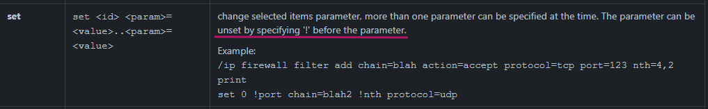

I like this:
If I get it right it essentially means leave all settings "as they are " BUT NOT src-address (that then is removed).
Clever.
This is actually documented Scripting - RouterOS - MikroTik Documentation
However unset is not in the docs, but you find it with TAB completion.
