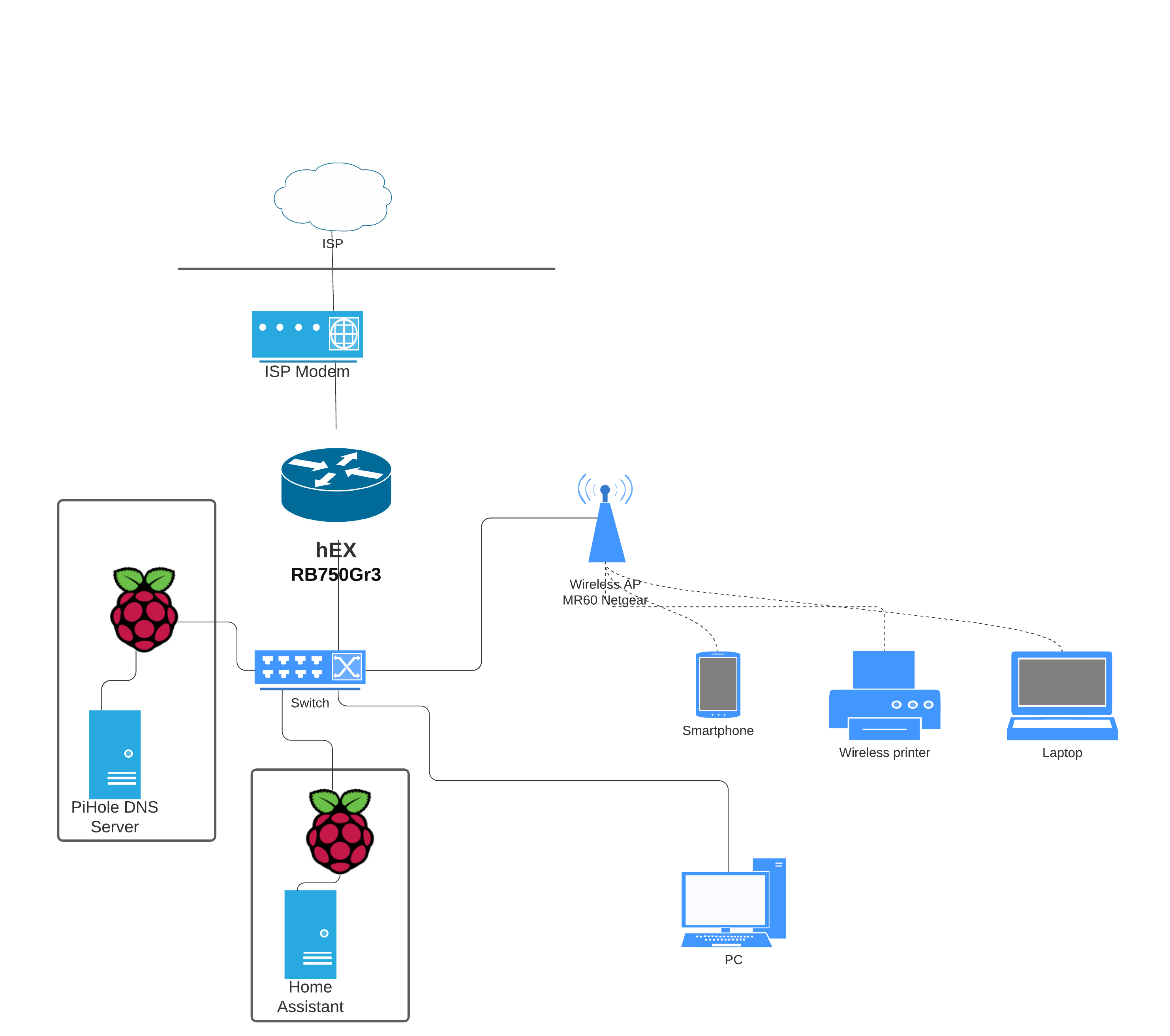

This is what I want to achieve;
A home network that;
  1. uses the hEX RB750Gr3 as DHCP server
  2. the hEX RB750Gr3 uses the PiHole as it’s only primary DNS
  3. the hEX RB750Gr3 will have a couple of reserved IP address (Pihole Server, Home Assistant Server, Wifi IoT lights etc)

I’m attaching a network schematic to further help You, help me.
All help is gratefully received

From your diagram you appear to be looking to create a flat network. Having a single DHCP Server and IP subnet is the easiest way to achieve that.
If you want to limit access to the Internet or other hosts of some devices, you can simply go down the firewall filter route, although that would only be effective if you either set these devices with a static IP or a static DHCP lease so that they will always have the same IP and the rules don’t need to be continually adjusted.
