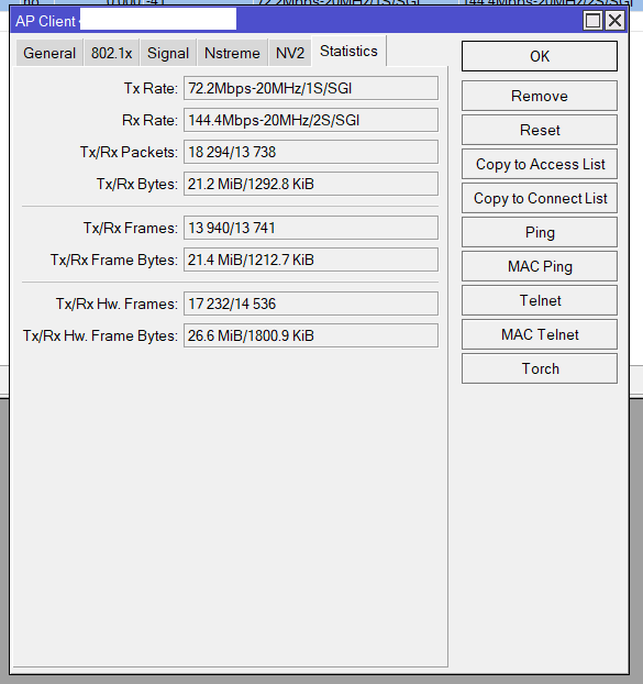

  1. “HW Frames/Frames” ratio gives an idea of the wifi retransmits happening.
  • i check this tonight and post here

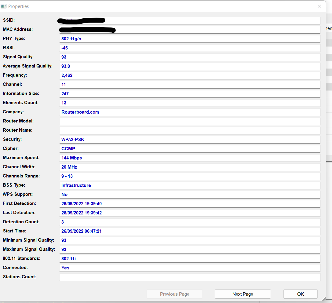

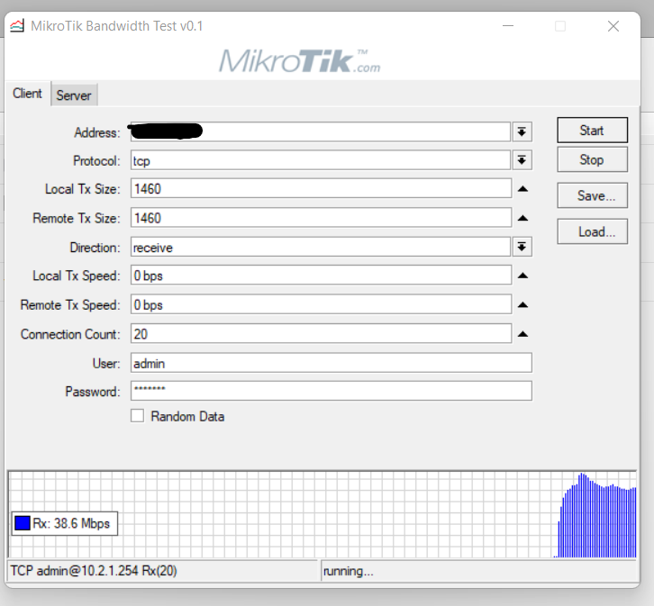

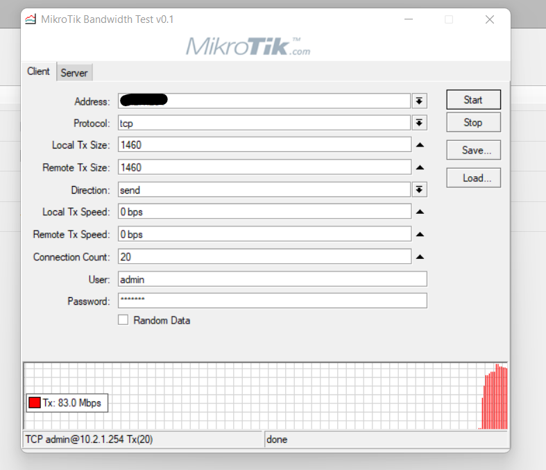

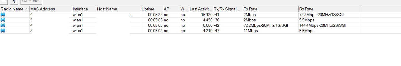

i try yo speed test with my notebook in wifi and HAP ac2 (the bare minimum) and this is result…
thank you again

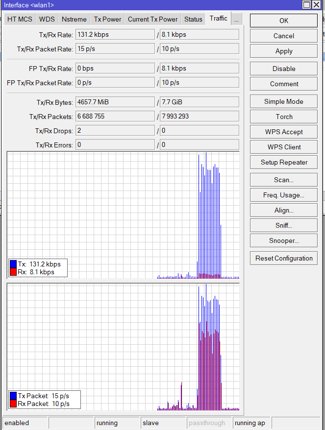

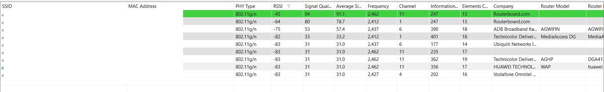

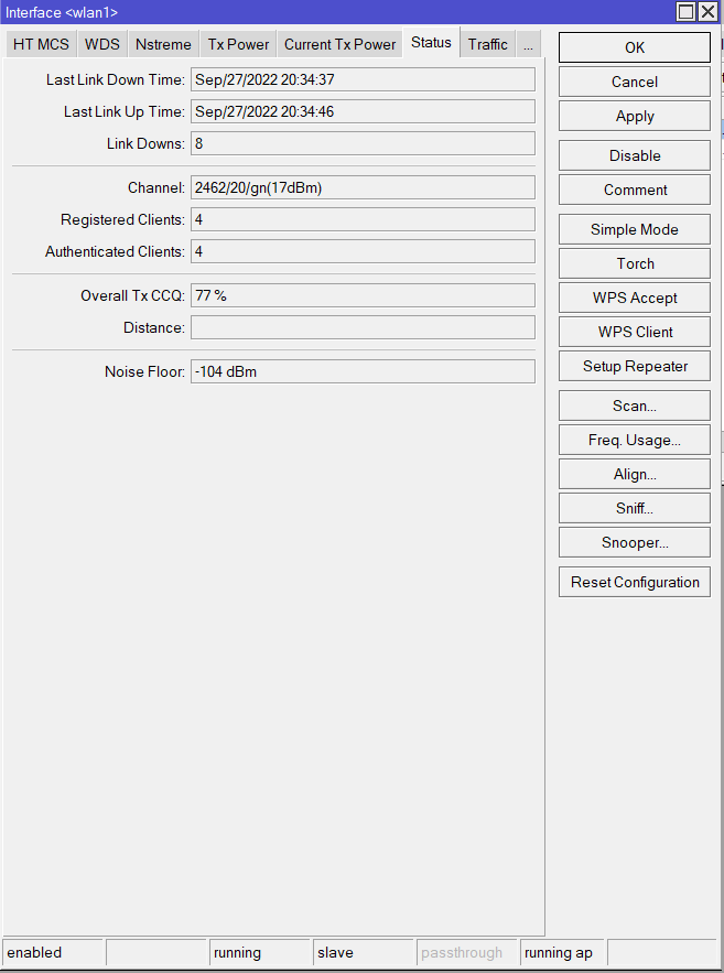

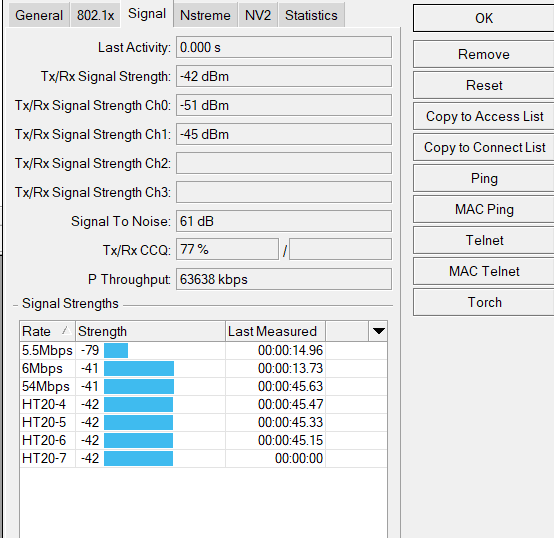

i check on my hap ac2 and wap.
now i set frequency = auto
and post screen …
if you is all ok or i can improve this installation?
thank you again

Thanks for all that information.
It is not always clear on what test or connection the screenshots are related.
I do see a very good signal strength (stronger than -40dBm could overload the receiver)
CCQ (77%) could have been better. I wonder if the disturbed signal quality is the reason why the 2S is reduced to 1S for transmission from the AP.
Signal disturbance can come from other devices but also caused by obstructions and metal objects (reflections) close to connection endpoints. (AP and client)
Some clients are clearly using 802.11b speeds (5.5Mbps and 11 Mbps).
An AP cannot forbid a client to use the “b”, even worse, the AP has to operate in “b” compatibility mode, if it detects “b” in the spectrum somewhere (so even foreign devices/connections can cause this). This happens even if the AP is set to G/N or N-only mode.
All by all this might slow down things to 63638kbps, but does not explain the 10Mbps slow download in your initial post.

screenshot is related to yesterday test , i have same problem and i have that value in mikrotik / notebook yesterday…
i don’t know about signal disturbance…
for 802.11b i think is smart bulb (tp link), i see 802.11b also in past when i have fritzbox and WAP as AP.
but i don’t have problem with speed…

Your test screenshots did not indicate any performance problem.
Only your first post, speaking about 10Mbps download has a low value, that is actually not visible in the test screenshots (63638Kbps throughput is OK)
The 144Mbps and 72.2 Mbps interface rates are the max values.
The stronger RB4011 antenna , will not do much good. The problem of 10Mbps download, is with the AP transmitting.
