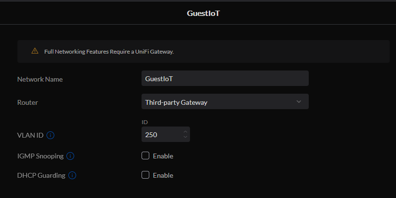

I did setup the Unifi APs to host a Guest SSID using VLAN 250 using the unifi controller:

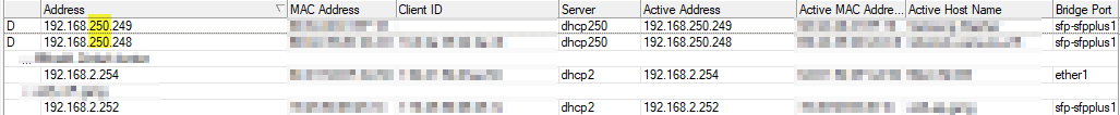

and the RB5009 does the dhcp’ing because the unifi switch (or the APs or both) are VLAN aware:
