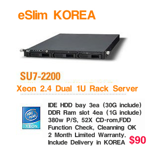

In case of me.
I’m using second hand server from http://www.Auction.co.kr (kind of ebay in Korea, Actually own by ebay)
It just 90$ + buy 2G IDE D.O.M(flash memory hdd) 20$ + 2 of 512 ecc reg ddr ram 20$/each
- 2 of Intel 1000MT dual NIC 40$/each
Total 230$. + + ROS Level 6 150$
Server spec
Xeon 2.4 dual (4core)
512 ecc reg ddr ram 2ea (I added 2 more)
30G IDE HDD(I’m using this HDD for backup and store log and bought D.O.M for ROS)
Dual Intel 1000MT Nic (I added 2 of second hand intel 1000MT dual nic)
3 HDD bay (2 remain)
380w power supply
52x CD-rom
FDD
I bought 10 of this server. using 4 now and reserved 6 for future expansion.
and it can handle 200Mbps (with 4 core) CPU Usage 30% average.
and I think it’s better then Personal Computer. Server architecture is different with PC. it is more stable.
I recommend to buy second hand server product from ebay.
You can also purchase supported and tested hardware at http://www.mikrotikrouter.com. Why mess with trying to get your own hardware to work right.
yeah right, because 90$ is totally not worth it
good price you found, hl1ill
+1 to you hl1ill. I’m a built, not bought kinda guy myself…especially when it saves so much $!
