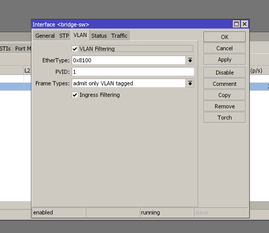

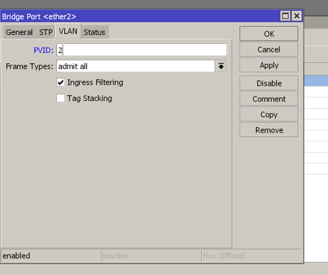

set port 1 to 8 PVID 1
set port 9 to 16 PVID 2
go to bridge and select vlan filtering, and vlan 1 as default ( so you will access the SW only from the sub nets of ports 1 to 8 ).
Now, this is not an exact explication of how to use vlans, but in your setup it should work, if you want to know more, do a google search on vlans.
This will be HW Offloaded, so you will have 10 Gbps wire speed.
