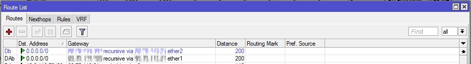

I can’t open the pic, so I can’t see anything.
http://hostpicture.eu/upload/big/2013/06/06/51b04c6be23ba.png
“No direct Link permitted”
This is odd.I give up try the link below.
http://items.dhost.ro/pic/routing-table.png
This looks strange. One of the default routes should be “A”. I saw that you run RC7, maybe it’s a bug. Is this device in production?

It should look like this:
Ok, after a restart they are like that :laughing: . But still can’t ping my /24 block only if i disable one of the BGP peers.
