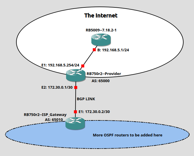

I am trying to create, in my home lab, a small scale version of an ISP. Specifically, I’m trying to create a BGP link between the “provider” router and “internal isp” that will allow me to pass traffic from inside the “internal isp” to the internet, so it will simulate a full ISP.
I have two hEX lites running the BGP link - both running ROS 6.49.18, the configurations are:
RB750 - “provider” router:

My network diagram:
Any pointers as to how I can resolve this?

The part that is/was confusing me, is that the “provider” router has full internet access - but that is because it’s on the 192.168.5.0/24 network, from the “provider” router, it has access to the Internet.
From what I’m reading, I need to create a NAT/Filter to route from 172.30.0.0/24 to the 192.168.5.0/24 - and this will need to be done on the “provider” router.
correct. you need srcnat or nat masquerade on providers interface facing the real internet.
even just for lab - there is not much of a difference from that in the real world schema. your providers router is your upstream isp. may it be tier 1 or 2 ‘regional isp’. and your internal isp could be tier 3 leaf isp.
you need to define your tier 3 isp ‘public - internet routable ip’ and your internal isp transport ip.
your tier 3 isp only need bgp default route from your upstream isp bgp peer. the rest is interior routing ospf to interconnect the internal network and to carry your ‘public ip’ for the subscribers. be it static or DHCP or ppp your choice your network design.
