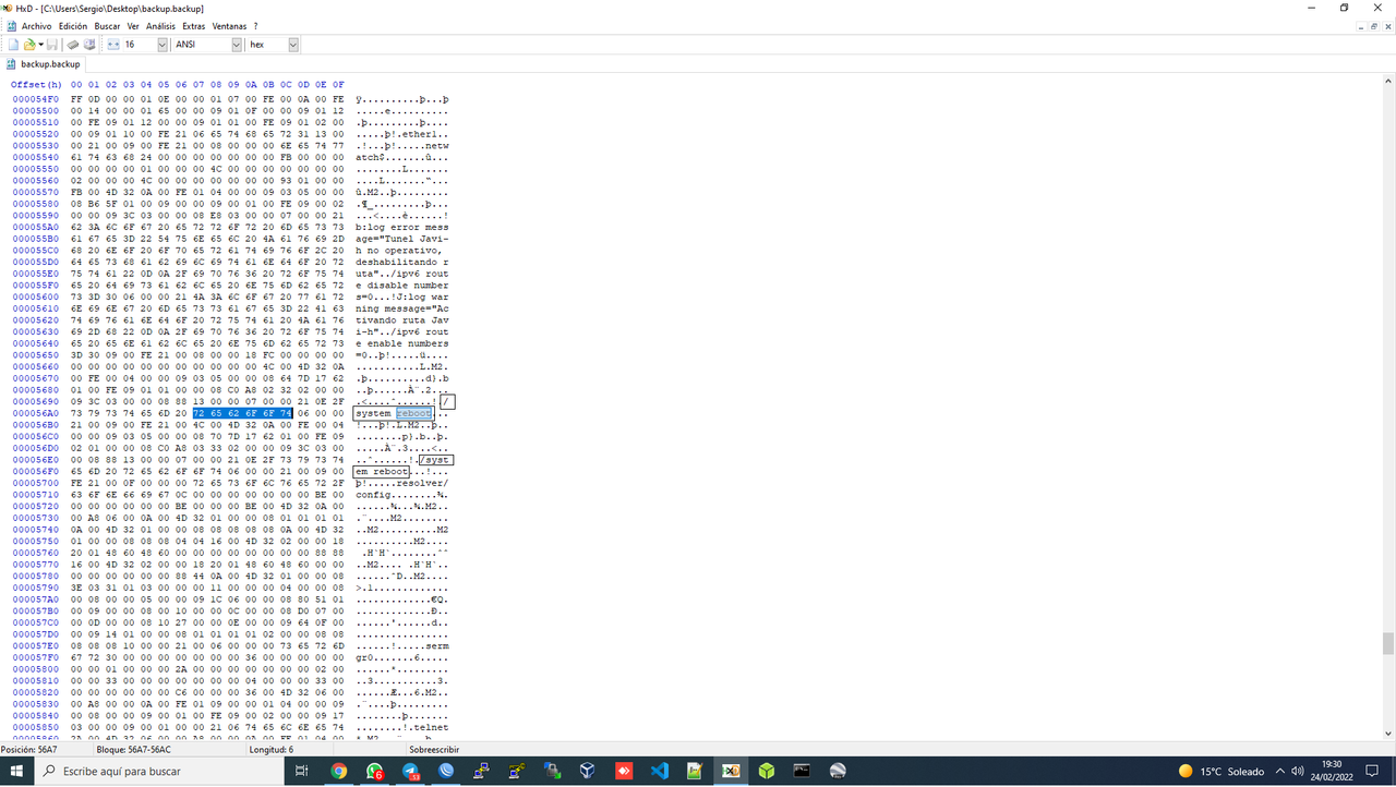

Thinking… and thinking… and thinkg… I forgot I repair firmwares on Ubiquiti and sometimes on Mikrotik… what I do? I open the .backup file (encrypted) to check if the commands on “at down” shows in plain text and… BINGO!!
Open the file with the HxD hex editor and search for the any word in the “at down” box… in my case, “reboot” and BINGO AGAIN!! You can see the command in “at down” box that it´s “/system reboot”
How to “try” to solve it… we rewrite this two commands with dots and save the file…
Then upload it to the Mikrotik (the same mikrotik because is a .backup file) and restore it… and BINGO!! Mikrotik working and in the boxes of “at down” we have the dots… now delete the netwatchs rules and now all fine…

How are you able to open an encrypted backup file in hex editor, search and change specific values, save and use it?
Is there no real encryption or where you able to decrypt and re encrypt the file?
I think, some personalized commands like that you put in “on up” and “on down”, comments and somethings are not encrypted… are in plain text… then the configurations such as ip-addresses, ip-routes, passwords, all this are encrypted…
You can see that I saved my ass with this trick…
Regards!!
Wow, you’re totally right. If you open a “AES-encrypted backup” in a hex editor like VSCode – I can totally search for stuff in /system/scripts and see all the RouterOS script code. Plain as day, once the ASCII charcodes are decoded. I assumed initially that somehow you had an unencrypted backup file, which isn’t the default, NOT an encrypted one where I would have thought your nifty trick wouldn’t work…
This may really helpful to @donsergiobut to anyone who want to store sensitive data in a script, this is a major problem. I guess I just assumed they encrypted the entire backup, not just a subset of the fields in the config. I suspect his behavior would surprise most people. I don’t use Cloud Backup but now I’m left wondering if leave some stuff in plain text when going to their cloud backup service.
Oh this is subtle. Poked around more here.
Apparently the CLI and winbox allow you create a backups with the “aes” or “rc4” encryption set, but the backup won’t be encrypted unless a password is set. Without a password= being set, it ignore the encryption= part. i.e. So even if “Don’t Encrypt” is UNCHECKED – which should mean “Should Encrypt” – winbox/CLI gives NO warning or error that you’re about to create an un-encrypted backup, even though an encryption type is set!
Now the help does in fact note this, in it’s description of the password field. While I imagine encryption does need some keying material (e.g. the password), neither winbox nor CLI should let you set “encryption=” if it’s not actually going to encrypt it. That’s just plain confusing for something important like this.
So likely why the OP thought he was using an “encrypted backup”, it wasn’t really encrypted.
