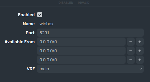

Each service in “IP Services” could be disabled or enabled for all interfaces only. There is one setting to turn it on/off. To limit access for each service you can select VRF or define list of IP ranges that could access that particular service. It is up to you what interface these ranges belong to.
On the other hand you can use firewall to drop packets trying to use particular service.
You have decide what way gives you more flexibility, less work or goes in pair with your future configuration.
