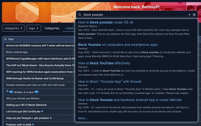

Have you tried at least to search the forum for that problem. There are dozens of topics on that.
