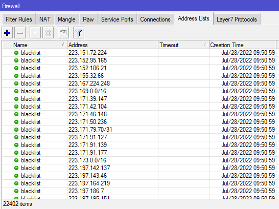

I setup a router firewall with a list of IPs to be blocked downloading a list of countries from one of those sites that make a mikrotik firewall configuration file for you.
I did this long time ago, on the router below in the screenshots, and forgot about it.
I have 2 questions.
First. I am testing to see if it actually works. I setup a manual IP address on that CountryIPBlocks list. It is not showing on the screenshot, but i set it up on top of the list.
It is an IP of a remote location i have access to for testing purposes in this case.
The list looks like this:
And this is how i am trying to make it work on the firewall:
So far, i am still able to login with WinBox from that specific IP i added to the block list, so the filter is not working. I watched a video in youtube and that seems to be the process to make it work, but in my case it does not. Do you know what am i doing wrong?

You are not giving us enough information. Screen captures are a horrible way to show us your configuration. Please export your configuration and post it. To export and paste your configuration (and I’m assuming you are using WebFig or Winbox), open a terminal window, and type (without the quotes) “/export hide-sensitive file=any-filename-you-wish”. Then open the files section and right click on the filename you created and select download in order to download the file to your computer. It will be a text file with whatever name you saved to with an extension of .rsc. Suggest you then open the .rsc file in your favorite text editor and redact any sensitive information. And in your case, please remove the 27K entries in the address list (we don’t need to wade through tens of thousands of lines of that. Then in your message here, click the code display icon in the toolbar above the text entry (the code display icon is the 7th one from the left and looks like a square with a blob in the middle). Then paste the text from the file in between the two code words in brackets.
With that said, restricting access to WinBox is via the Input Chain, not the Forward chain - hence the reason you can still access WinBox from your “blocked” address.
Use RAW. Example:
/ip firewall raw add action=drop chain=prerouting in-interface-list=WAN src-address-list=blacklist
You can try reducing the list. https://tehnoblog.org/ip-tools/ip-address-aggregator/

Since OP is using stateful firewall, it’s still better to block in firewall filter rules. Only the order of rules needs to be modified.
Remember that firewall filter rules are executed in order from top to bottom and first one matching is then applied to packet, the rest are not executed anymore. Security comes first so one has to make sure that things that need to be blocked are actually blocked. But when it comes to performance, earliest rules have to be the ones matching the most passing packets. And the most frequent type of packets is the one matching connection type of established and related. Other packets types (new, untracked and invalid) are relatively rare and it’s good to deal with those later. (Ongoing connection can have high number of packets while blocking new connection only has to block one packet and connection never establishes.)
Dropping packets in raw can be more resource friendly because dropped packets don’t hit connection tracking machinery (which is very costly operation), but OTOH all packets need to be checked and if check is not trivial (matching against 27k IP addresses IMO doesn’t count as one) and if only a few packets match droping them in raw can even be more resource demanding than in filter.
There’s use case when droping packets in raw is definitely better: when dealing with DDoS attack … the rule there is most of times trivial (e.g. drop any udp packet with dst-port=53) making matching process a quick one and there are many packets that match due to nature of attack.
