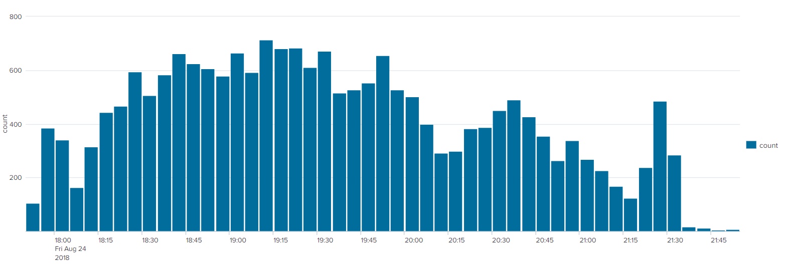

Now looking at Splunk, number of hits in the last rule goes down from more than 400 hits pr 5 min to less then 10 minutes. (after 21:30)
Look at the graph:
Graph made by using Splunk: http://forum.mikrotik.com/t/tool-using-splunk-to-analyse-mikrotik-logs-3-3-graphing-everything/121810/1
