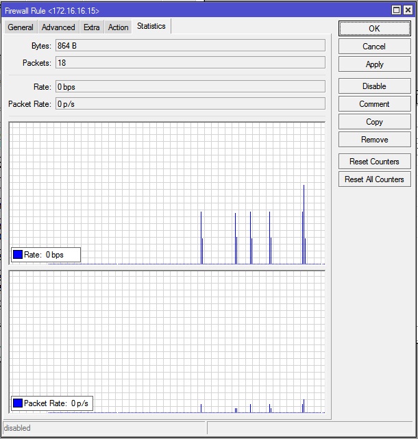

chain=hs-unauth action=add-src-to-address-list protocol=tcp \
address-list=attack address-list-timeout=5m
Now I can catch those attackers src-address. But it gets some IP from good clear connections. Then I tried:
address-list=attack address-list-timeout=5m connection-limit=40,32
But can`t catch. Then tried like that:
address-list=attack address-list-timeout=5m dst-port=443
Same result can`t catch bad connections.
Okay If firewall rules can`t catch it, need to add script to find those connections. Please help me to fo this.
If you have found the right chain then try to restricting all https traffic from one host to say about 20 connections?
Skip adding them to a list just drop them.
Try that and see if it helps?
Yes, But most interesting of those traffics is “forward” chain cant catch it. Only "hs-unauth" chain can catch not authorized tcp connection tries, but not stable (see the screenshot). Okay, it doesnt work stable but works. Then next step is try to catch any tcp 443. Woow. But can`t. Just no traffic catch. But bad connections still in firewall connections and CPU load 100%.
