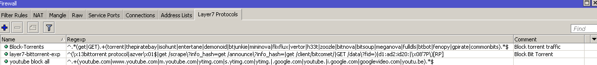

/ip firewall layer7-protocol
add comment="Mikrotik Block Torrent" name=layer7-bittorrent-exp regexp="^(\\x13bitt\
    orrent protocol|azver\\x01\$|get /scrape\\\?info_hash=get /announce\\\?inf\
    o_hash=|get /client/bitcomet/|GET /data\\\?fid=)|d1:ad2:id20:|\\x08'7P\\)[\
    RP]"

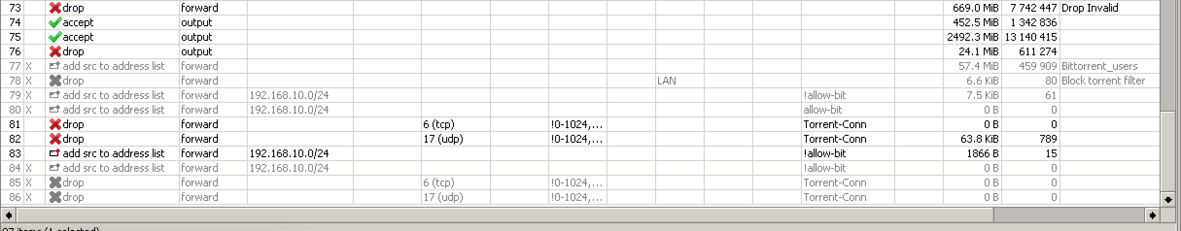

2.
add action=add-src-to-address-list address-list=Torrent-Conn \
    address-list-timeout=2m chain=forward layer7-protocol=\
    layer7-bittorrent-exp src-address=192.168.10.0/24 src-address-list=\
    !allow-bit
    address-list-timeout=2m chain=forward p2p=all-p2p src-address=\
    192.168.10.0/24 src-address-list=!allow-bit
3.
add action=drop chain=forward dst-port=!0-1024,8291,5900,5800,3389,14147,5222,59905 protocol=tcp \
    src-address-list=Torrent-Conn
add action=drop chain=forward dst-port=!0-1024,8291,5900,5800,3389,14147,5222,59905 protocol=udp \
And this is the export on my router:
add name="youtube block all" regexp="^.+(youtube.com|www.youtube.com|m.youtube.com|ytimg.com|s.ytimg.com|yti\
    mg.|.google.com|youtube.|i.google.com|googlevideo.com|youtu.be).*\$"
add comment="Block torrent traffic" name=Block-Torrents regexp="^.*(get|GET).+(torrent|thepiratebay|isohunt|\
    entertane|demonoid|btjunkie|mininova|flixflux|vertor|h33t|zoozle|bitnova|bitsoup|meganova|fulldls|btbot|\
    fenopy|gpirate|commonbits).*\$"
add comment="Block Bit Torrent" name=layer7-bittorrent-exp regexp="^(\\x13bittorrent protocol|azver\\x01\$|g\
    et /scrape\\\?info_hash=get /announce\\\?info_hash=|get /client/bitcomet/|GET /data\\\?fid=)|d1:ad2:id20\
    :|\\x08'7P\\)[RP]"

add action=add-src-to-address-list address-list=Bittorrent_users address-list-timeout=5m chain=forward \
    comment=Bittorrent_users disabled=yes layer7-protocol=*2
add action=drop chain=forward comment="Block torrent filter" disabled=yes layer7-protocol=Block-Torrents \
    log=yes out-interface=LAN
add action=add-src-to-address-list address-list=Torrent-Conn address-list-timeout=2m chain=forward \
    disabled=yes layer7-protocol=*4 src-address=192.168.10.0/24 src-address-list=!allow-bit
    disabled=yes p2p=all-p2p src-address=192.168.10.0/24 src-address-list=allow-bit
    layer7-protocol=layer7-bittorrent-exp src-address=192.168.10.0/24 src-address-list=!allow-bit
    disabled=yes layer7-protocol=layer7-bittorrent-exp src-address=192.168.10.0/24 src-address-list=\
    !allow-bit
add action=drop chain=forward disabled=yes dst-port=!0-1024,8291,5900,5800,3389,14147,5222,59905 protocol=\
    tcp src-address-list=Torrent-Conn
    udp src-address-list=Torrent-Conn

The following worked for me in the past:
add name=torrents regexp=“^.(get|GET).+(torrent|thepiratebay|isohunt|entertane|
ova|fulldls|btbot|fenopy|gpirate|commonbits|1337x|bitlord|rarbg|yts|eztv|piratebay|nya
a|zooqle|idope|kat|torlock|demoniod|monova|toorgle|seedpeer|torrentz|rartv|ettv|bittorrent).
add action=drop chain=forward comment=“block torrents” layer7-protocol=torrents
src-address-list=local
add action=drop chain=forward comment=“block torrents - dns request” dst-port=
53 layer7-protocol=torrents protocol=udp src-address-list=local
This is not working anymore. tested in 07/2020 and torrents are working with no issue…

For me, following works:
add name="Torrent sites" regexp="^.+(torrent|rarbg|thepiratebay|isohunts|enter\
    tane|demonoid|btjunkie|mininova|flixflux|torrentz|vertor|h33t|btscene|bitu\
    nity|bittoxic|thunderbytes|entertane|zoozle|vcdq|bitnova|bitsoup|meganova|\
    fulldls|btbot|flixflux|seedpeer|fenopy|gpirate|commonbits|d1:ad2|tracker|a\
    nnounce).*\$"
add comment="Block Torrents" name=block-torrents regexp="^(\\x13bittorrent pro\
    tocol|azver\\x01\$|get /scrape\\\?info_hash=get /announce\\\?info_hash=|ge\
    t /client/bitcomet/|GET /data\\\?fid=)|d1:ad2:id20:|\\x08'7P\\)[RP]"
    address-list-timeout=2m chain=forward comment="Torrent Block 1/4" \
    layer7-protocol=block-torrents src-address=192.168.2.0/24 \
# p2p matcher is obsolete please use layer7 matcher instead
    address-list-timeout=2m chain=forward comment="Torrent Block 2/4" p2p=\
    all-p2p src-address=192.168.2.0/24 src-address-list=!allow-bit
add action=drop chain=forward comment="Torrent Block 3/4" dst-port=\
add action=drop chain=forward comment="Torrent Block 4/4" dst-port=\
