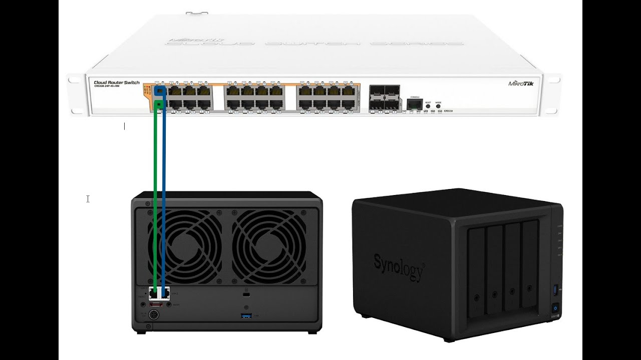

This is the setup I am attempting to achieve.
Again, I appreciate the guidance.
Remove ports ether1 and ether2 from the Bridge.
Then create the bonding interface with ports ether1 and ether2.
Finally, add the bonding interface to the Bridge.
As simple as that…
But the question is… That synology is capable to do bonding?
If a peripheral has multiple Ethernet ports, it doesn’t necessarily mean they can be bonded together…
But the question is... That synology is capable to do bonding?
If a peripheral has multiple Ethernet ports, it doesn't necessarily mean they can be bonded together...
I know for sure, got it working (though it is called link aggregation):
https://kb.synology.com/en-global/DSM/help/DSM/AdminCenter/connection_network_linkaggr?version=6
Yes, but just from the pics, not all can know if that version is compatible or not to do bonding
Looks like DS416play or alike. If so, it can do bonding.
Most current devices are running DSM7 nowadays.
Exactly…
It supports 802.3ad…
