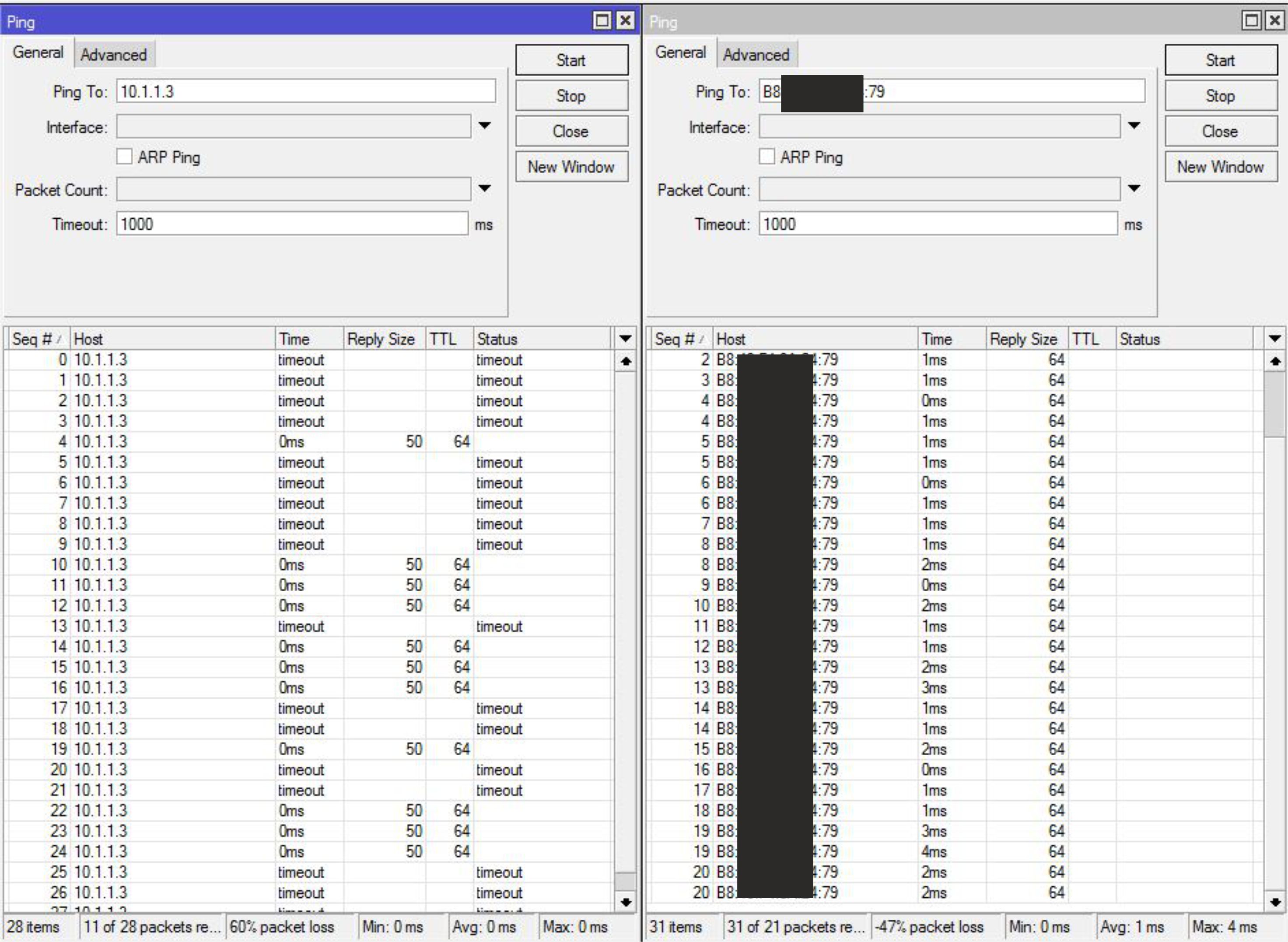

I recently launched a bonding between two RB750g3 boards. Тhe scheme is shown on the attached picture. Оn one side Bonding have ip sdres 10.1.1.1/24 on other side ip: 10.1.1.2/24. Ping between bonding is working. Bonding works but I can not ping the intermediate devices (wlan bridges).
А (750gr3) eth1–> A1 -wlan <--------> B1-wlan → eth1 B (750gr3)
А (750gr3) eth2 → A2 -wlan <--------> B2-wlan → eth2 B (750gr3)
Configuration of wlan bridges is A1:
add address=10.1.1.3/24 interface=bridge1 network=10.1.1.0
add check-gateway=ping distance=1 gateway=10.1.1.1
When I ping up with ip address there are many losses. When I ping up with mac ping there are NO losses. I can not ping wlan briges A1,A2,B1,B2 from bondin sides. Can I have a bit of help.
P.S. On the photo with mac-ping you can see below that there is a loss but this is a bug that has not yet fixed it by at Mikrotik.

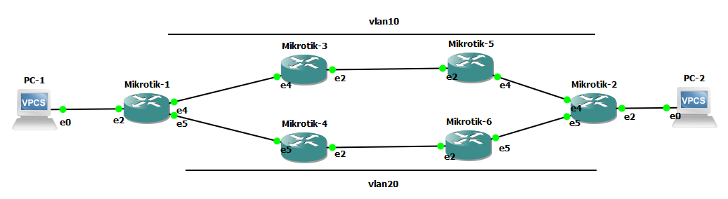

I replicated your setup in GNS3, together with your problem lost of packets and intermittent responses!
Problem: to be able to ping A1 from A, packets need to go the “upper” route always, and that is not guaranteed with bonding.
Solution for the above problem: define (management) vlans, one for upper path and one for lower path. make all 4 bridges participate in those vlans and have ips on them, not the bonding channel. You’ll be able to manage them over these vlans.
This works because vlan is a “separate” interface not participating in bonding and is as result consistent.
The transit / bonding traffic goes over the bridged paths, and doesn’t use vlans.
R1:
 #   ADDRESS            NETWORK         INTERFACE
 0   192.168.51.1/24    192.168.51.0    ether2
 1   192.168.50.1/32    192.168.50.2    bond2
 2   192.168.61.1/24    192.168.61.0    v10
 3   192.168.62.1/24    192.168.62.0    v20
R3
 0   192.168.61.3/24    192.168.61.0    v10
R4
 0   192.168.62.4/24    192.168.62.0    v20
R5
 0   192.168.61.5/24    192.168.61.0    v10
R6
 0   192.168.62.6/24    192.168.62.0    v20
R2
 0   192.168.52.1/24    192.168.52.0    ether2
 1   192.168.50.2/32    192.168.50.1    bond2
 2   192.168.61.2/24    192.168.61.0    v10
 3   192.168.62.2/24    192.168.62.0    v20
I’ve made the settings on the scheme and it’s all working! Of course, I added a static routing because I could not ping addresses from the internet ex. google.com
