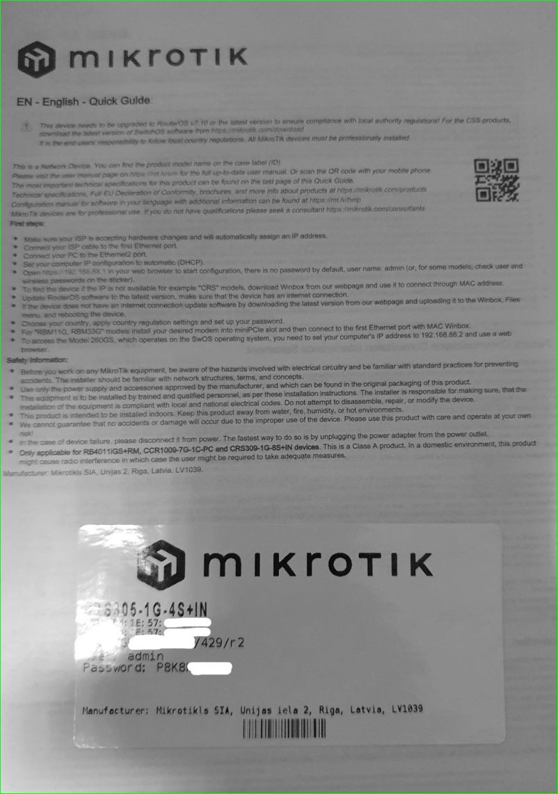

Hi, everyone
I had a similar situation with the same device. After careful examination of the package I found the following (see attached picture).
I have only one question for the manufacturer - what the hell? What is the secret meaning of this action?
SerDan, what is your complaint?
There is no secret.
There are some requirements for security mandated by the EU that the good Mikrotik guys believe they are complying with in this way.
