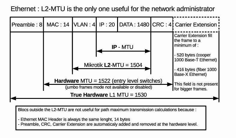

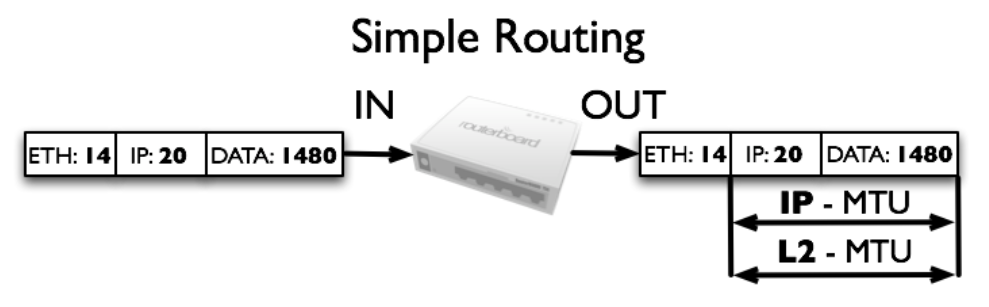

Second, Mikrotik L2MTU never takes into account the size of the Ethernet header, it takes only DATA + IP header + VLAN and eventual other encaps. It means that when the L2MTU is 1500 for example, you can have a max MTU of 1500, for simple routing without VLAN.
Mikrotik L2MTU is Data + IP header. See the example for simple routing without VLAN :
You are confusing L2MTU with Hardware MTU. Hardware MTU takes into account the size of the Ethernet header :
Then when you have a L2MTU of 1600 (in my case i absolutely need it because my provider is set to this value for tunneling), you should have a max MTU of 1600, not 1599. And we should have an error message when trying to put more than 1600. Not a silent revert to 1500 like actually.
