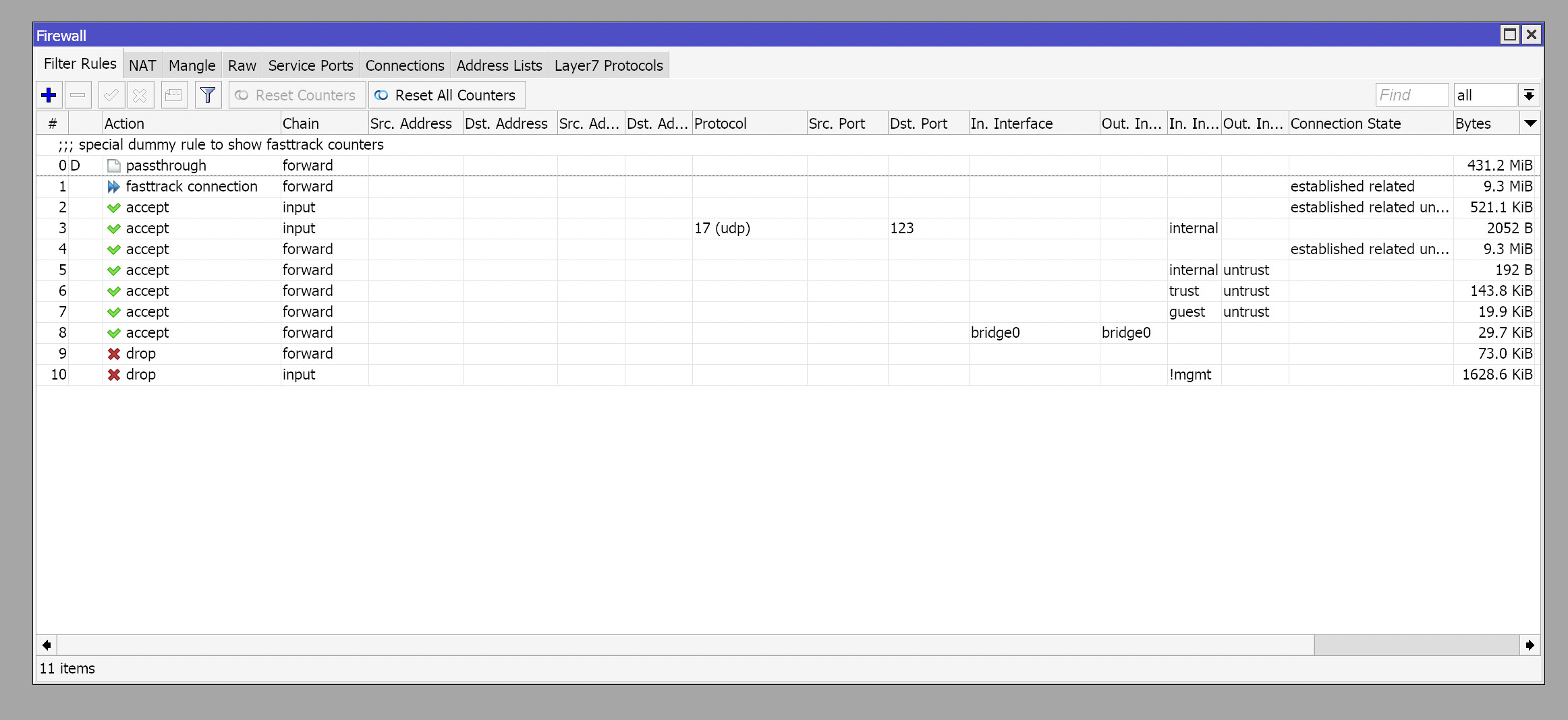

I set up bridge firewall and created a bridge filter rule for vlan 10 and i can only see there is traffic going but not much. But I cannot access a printer from one of the bridge port to another bridge port. I figured out
add action=drop chain=forward
is blocking the traffic. However, if I enable from “vlan10” as in interface to “vlan10” as as out interface, I still cannot access the printer from another bridge port. After checking the log of that firewal rule 9 which drops every forwarding traffic, I see the router only detects the traffic as from “bridge0” instead of “vlan10” interface. Is this normal that the device cannot distinguish the traffic is from a slave interface “vlan10” of the “bridge0”? Should this be considered a bug?

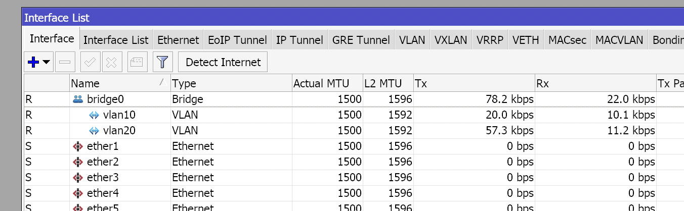

/interface vlan
add interface=bridge0 name=vlan10 vlan-id=10

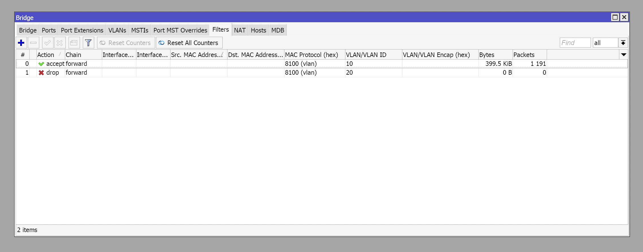

/interface bridge filter
add action=accept chain=forward in-bridge=bridge0 mac-protocol=vlan \
    out-bridge=bridge0 vlan-id=10
add action=drop chain=forward in-bridge=bridge0 mac-protocol=vlan out-bridge=\
    bridge0 vlan-id=20

add action=fasttrack-connection chain=forward connection-state=\
    established,related hw-offload=yes
add action=accept chain=input connection-state=established,related,untracked
add action=accept chain=input dst-port=123 in-interface-list=internal \
    protocol=udp
add action=accept chain=forward connection-state=\
add action=accept chain=forward in-interface-list=internal \
    out-interface-list=untrust
add action=accept chain=forward in-interface-list=trust out-interface-list=\
    untrust
add action=accept chain=forward in-interface-list=guest out-interface-list=\
    untrust
add action=accept chain=forward in-interface=bridge0 out-interface=bridge0
add action=drop chain=input in-interface-list=!mgmt

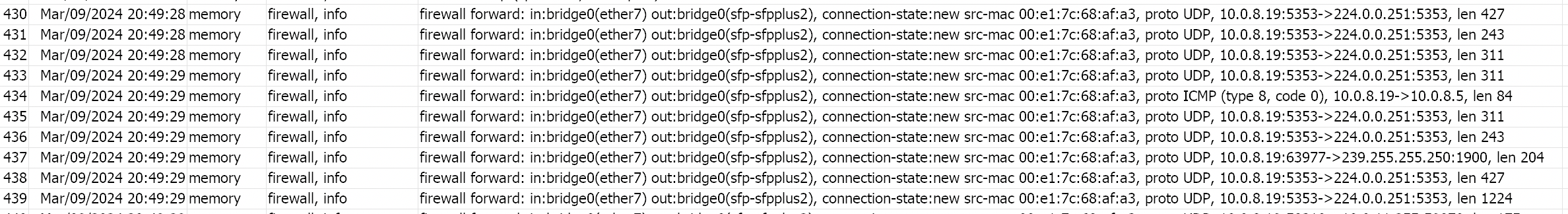

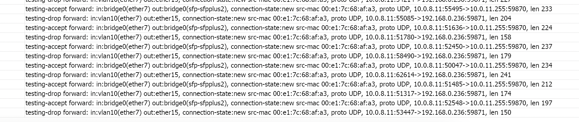

After further testing, the firewall can sometimes also pickup the traffic from vlan interfaces that are under the bridge.
testing-accept:
add action=accept chain=forward in-interface=bridge0 \
    log=yes log-prefix=testing-accept out-interface=bridge0 src-address=
testing-drop:
add action=drop chain=forward log=yes log-prefix=testing-drop

Well, things are clear then, I thought you were mocking me using a router to set it up as a “special” firewall. No worries, sorry for my replies. Basically I setup the firewall to drop any forward or input traffic except the explicitly allowed input/forward traffic. After I turned on the bridge firewall, to allow traffic from port a to port b within vlan 10, the firewall rule that drops every forward traffic blocks that traffic, and I thought well, I need a rule that allows traffic from vlan10 in to vlan10 out. However, strangely, after setting up a firewall rule explicitly allow vlan10 in and vlan10 out, the drop-all rule is still picking up the traffic and blocking the traffic from vlan10 → vlan10. After further investigating the logs generated by the rule, the router is picking up traffic from vlan10 and it considers the traffic which comes from vlan10 is coming from bridge0. That’s really weird, and that’s what confuses me. Though the problem can be solve by adding a rule explicitly allow traffic from bridge0 to bridge0, but still, why ROS is thinking the traffic that comes from vlan10 is from bridge0 because in my setup bridge0 itself is actually vlan1 untagged, vlan10 and 20 are more like sub-interfaces under bridge0.
