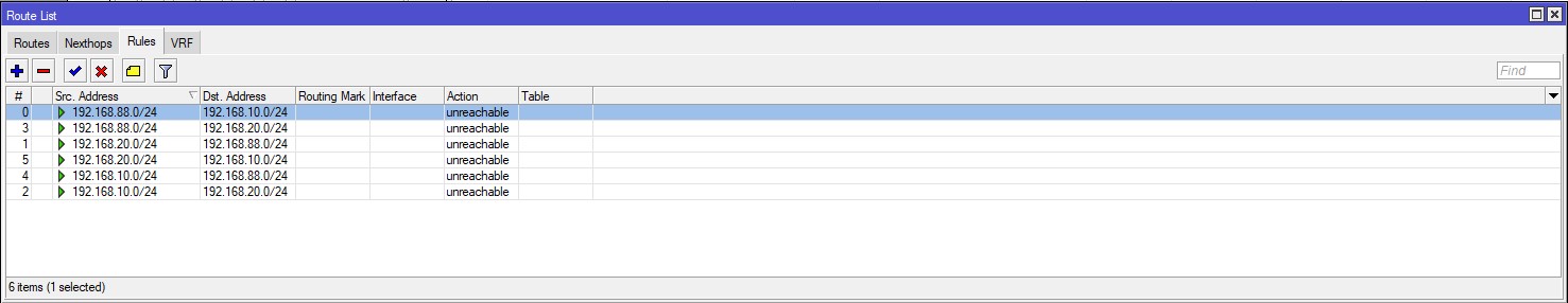

One more i want to ask - I have such rules in “Routes List” - is it the same or firewall is better ?
What most do is simply have a rule at the end of the forward chain for example
add chain=forward action=drop comment=Drop all Else
Thus unless you have rules above this allowing traffic, EVERYTHING else is blocked.
So typcially one has
allow LAN interface list to WAN interface list for internet
allow admin to all subnets
allow LAN interface list to shared printer
etc…
