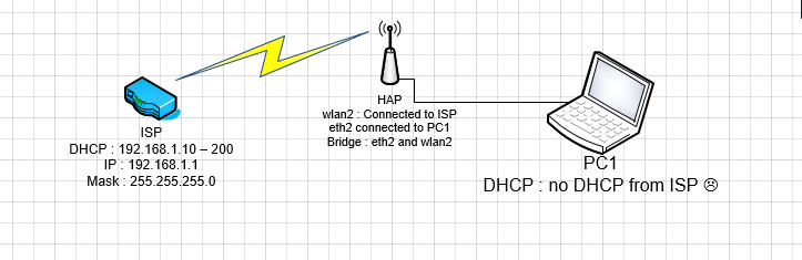

I would want use a bridge eth2 and wlan2.
wlan2 is connected on a Wi-Fi AP (box), and eth2 on my computer.
I would want get a DHCP of my box on my computer.
it’s possible ? how make ?

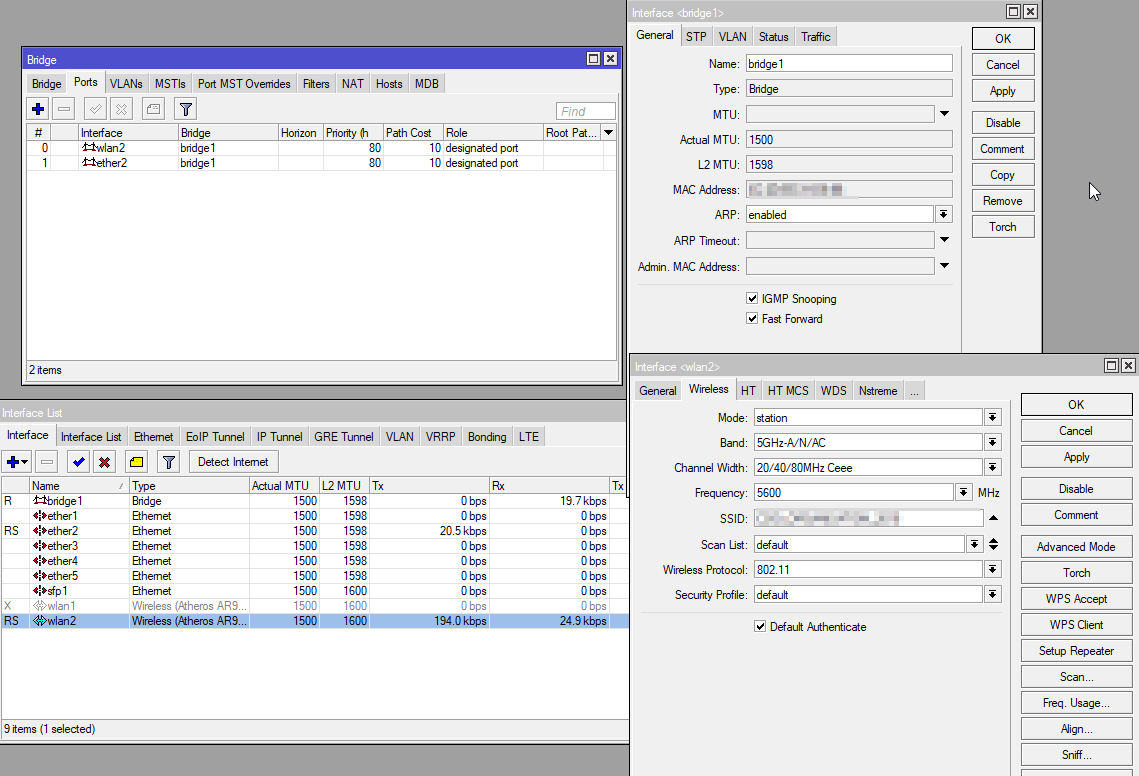

This is my configuration :

What I would like to achieve is very simple, I just want to add the wlan2 interface on the bridge1 so that my computer, which does not have a Wi-Fi card, is on the same network as the ISP box.
I just want to use the HaP, like a Wi-Fi → ethernet converter.
But that does not work … my computer does not get IP from DHCP server of the ISP box :frowning:
My HaP :

Maybe station-pseudobridge-clone mode is what you’re looking for? I don’t have anything to test it with, but from description it could be it.
Yes. I’ve just spent quite some time finding out how to do that using bridge dst-nat rules, dealing with DHCP and ARP, and it comes out it is actually readily available in ROS :slight_smile:
In station pseudobridge clone mode, the Wi-Fi not connect to Wi-Fi of my ISP box
If you didn’t do it already, try to manually enter the MAC address (station-bridge-clone-mac=<computer’s MAC address>), to make sure that nothing else is chosen automatically.
Hi Sob,
It’s working :slight_smile:
I do not understand why in bridge wlan with lan is so complicated? because with this solution, I can only put one PC, if ever want to put several comment I do? I tried to put the MAC address of the bridge in bridge-bridge-clone-mac, but it does not work …
