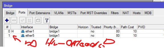

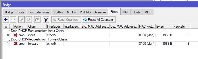

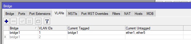

But it should work nevertheless, unfortunately your config will never work. Because you have bound the VLAN-Interfaces to the physical Interfaces and not to the Bridge. On the other hand you are trying to implement Bridge-Filter (in the Bridge you havent bound the interfaces too). This is not the way it works in ROS, it will go (if you want to implent Bridge-related things, not HW-Switch-Chip ACLs):
  1. create a Bridge
  2. enable VLAN-Filtering (this will change the Switch from a non-VLAN-aware SVL-Switch to a VLAN-aware IVL-Switch)
  3. create VLAN-Interfaces and bound them to the Bridge (created in step 1)
  4. implement your Bridge-Filters + confirm that they work if the ports are Hardware-offloaded - if no, disbale HW-offloading on these ports
I can confirm, with this config, Bridge-Filter will work as expected with ROS v7.1.1.
This will drop DHCP-requests to the router itself and/or ot another DHCP in the same VLAN1.
