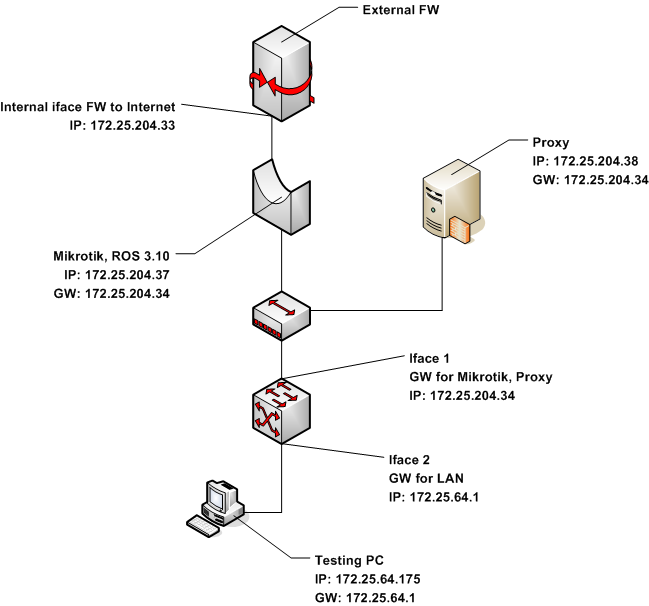

OK, I included network diagram, configuration of Mikrotik was stated early.

I think, you try to dst-nat to the same interface where request come from. so packets return to client from proxy directly, not via ROS, so ROS cannot ‘un-NAT’ them. you proxy should communicate with clients via RouterOS
Sorry, I didn’t understand your explanation. Can you be more specific? Can you, for example, repair my dst-nat rule?
you should either move your proxy to other subnet, or do something like you did with broute:
/ip firewall mangle add src-address=172.25.64.0/24 action=mark-routing new-routing-mark=redir
/ip route add  dst-address=0.0.0.0/0 gateway=172.25.204.38 routing-mark=redir
