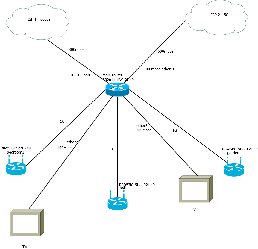

Am running the topology attached. In short: two ISP-s, 5G is in separate VRF. So my TV-sets are using routing rule to go out via 5G connection. All other using Fibre connection. I have every port in every MT device Bridge configuration HW offload off and on 100 mbps ports have Flow control on. This is quite stable atm, but still i see a lot of RX pause on TV 100mbps ports (main router has 5x1gbps and 5x100mbps ports).

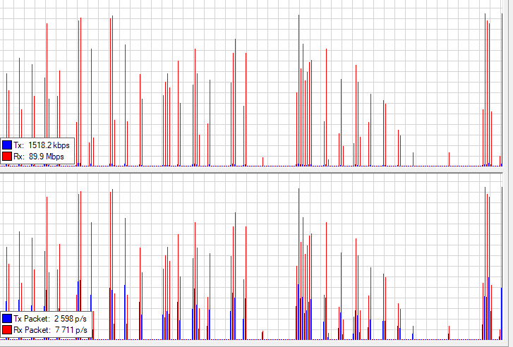

Well, my IPTV uses HLS ans it is pretty bursty as what i see from Mtik interface graph. Those bursts are like 4000 up to 8000 pps and up to 87 mbps. I don’t think kind of 100 or even 1000 packets queue size could help somehow. so i’ve created new queue with size 4000 packets and it doesn’t seem to be working too. See those empty sports on graph? during them TV starts to buffer.
